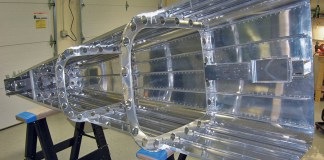

Another consideration was that we were working with the first quickbuild fuselage to be produced by Zenith Aircraft, so there was a bit more scrutiny of work that had been done by the factory. Sure enough, Warren found that the vertical stabilizer/rudder had a decided tilt to one side when it was first bolted into place. Armed with a measuring tape, a laser level and a plumb bob, he set out to find the cause.
“Taking a plumb bob up to the top of the rudder, you could see it was out quite a bit,” Warren said. “Aft er taking measurements at different points along the length of the fuselage and seeing to make sure they were all plumb and level, I found that the end of the fuselage had a slight twist to it.” A-ha! Eureka!
That twist was enough to displace the top of the rudder by almost a full inch, and after contacting Zenith, Warren found out what the probable cause might be. It was likely that the fuselage had been jostled during the factory construction process, and had shifted slightly during the installation of a couple of rudder mounting components. After taking some digital photos of the problem and emailing them to Zenith, replacement parts quickly showed up, along with an apology for the trouble.
There were some other minor discrepancies with the pre-constructed fuselage, but nothing really significant. There were a couple of quarter-size dents around blind rivets, caused by too much space between the outer skin and the underlying support structure. One of the top skins wasn’t cut quite straight, giving the forward edge a noticeably wavy appearance. One of the bottom skins was a couple of millimeters oversize, preventing the gear legs from dropping into the channel until some trimming was done. But these things aren’t showstoppers unless you have your heart set on building a grand champion. And if that’s where you’re headed, I’d suggest building much of the airframe yourself to ensure that it’s as immaculate as humanly possible. (Assuming, of course, you possess the skills to achieve immaculate construction.)
