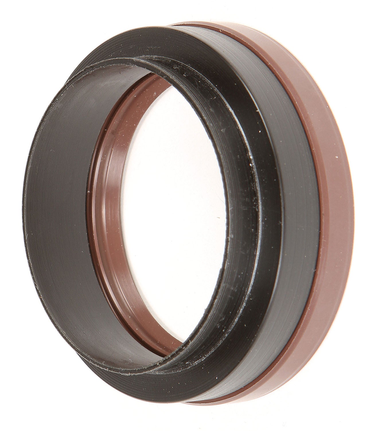

Never hammer directly on the surface of the seal. Always use a sleeve to provide even pressure, and avoid cocking the seal. A properly sized installation sleeve will have an outside diameter slightly smaller than the bore size, and the center of the sleeve should be relieved so pressure is applied only at the outer portion of the seal face.

The seal I needed to install was a metric 55 I.D. x 72 O.D. x 8 W (2.165 x 2.835 x 0.315 inches). An ideal sleeve would be slightly smaller on the O.D. to assure the sleeve won’t hang up on the edge of the seal housing, and slightly larger on the I.D. for shaft clearance. For my seal, something close to metric 55.5 I.D. x 70 O.D. (2.2 x 2.76 inches) would be perfect. The nearest size commercial pipe or tube that you could modify to make a sleeve of that dimension would have a 3-inch O.D. with a 0.5-inch wall (2-inch I.D.). That’s not a size most people have lying around. A section of 3-inch diameter bar would work, but making a sleeve from solid stock would be a lot of machine work.

What I did have was some 2.5-inch by 0.125-inch wall aluminum tubing and some scraps of Delrin and nylon plastic. By itself, a tube of that dimension would not be suitable, but by adding the plastic bushings at each end I was able to make an ideal seal press sleeve.
The seal bushing was machined to the face dimensions mentioned above (2.2 x 2.76 inches). A chamfer was added to the I.D. to provide some additional clearance for the seal lip. The bushing I.D. was made to closely fit the prop shaft. The design concentrates all the pressing forces on the outer part of the seal, which is where you want it, and the non-marring characteristics of plastic make for an ideal interface between both the seal and the shaft.

The rear bushing design was simply to create a central face to tap home the seal with a mallet.
