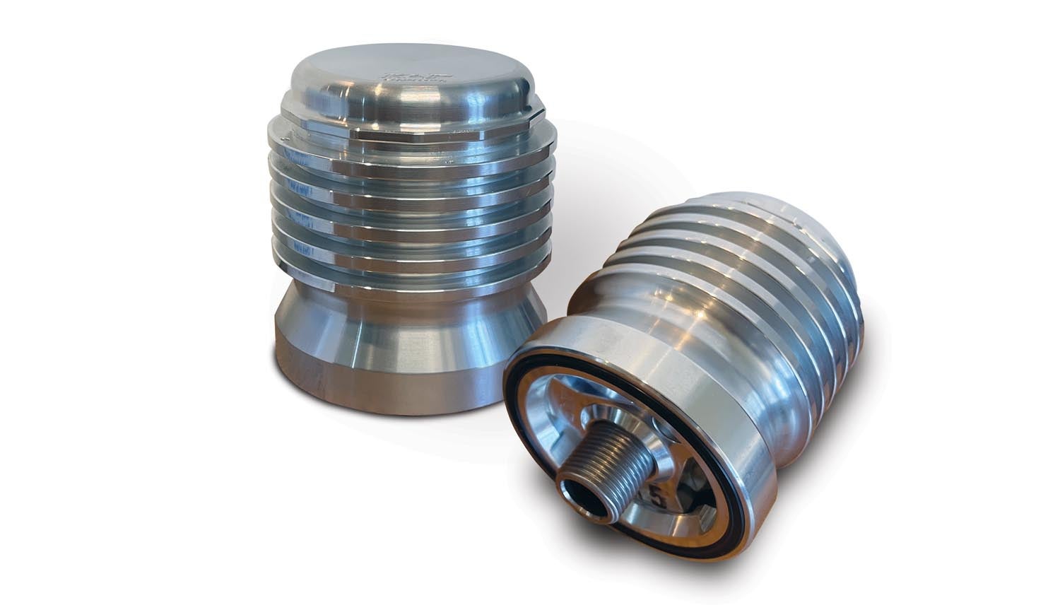

The permanent filter is smaller in diameter, shorter, and ribbed (for cooling) compared to the standard disposable filter.
Homebuilders searched their favorite forums to see if anyone had an extra filter on the shelf when it came time for an oil change, and as a hopeful sign of civility, many filters changed hands so that pilots could continue to fly. Some oil-change intervals might have been fudged—but for personal Part 91 operations, nothing says that you can’t go an extra 10 hours if you choose to do so. Not so lucky were flight school and rental-fleet operators, many of whom discovered that they had to find filters—at any cost—or stop operating some (or all) of their aircraft when inspections and oil changes came due. Lack of a $40 oil filter turned into much lost revenue.
Fortunately, there is—and has been for many years—an option to spin-on disposable filters. And no, I am not talking about going back to the simple oil screens that engine manufacturers used for over half a century before disposables came along. The original screens (I had a couple on my early airplanes) were comparatively very coarse, which meant they needed to be cleaned and the oil changed every 25 hours, according to Lycoming. Spin-on filters allowed intervals to be stretched to 50 hours—a welcome cost savings for aircraft owners, both certified and Experimental. Spin-on filters had, of course, been used in automobiles for a century—but took a little longer to make their way into aviation. Now, of course, they are pretty much the de facto standard. But an alternative is the permanent, cleanable filter that attaches to the same adapter as a disposable, spin-on filter.
Pioneered in general aviation by Challenger Aviation, the permanent filter has economic advantages in the long run (it will pay for itself after a certain number of oil changes) and reduces waste. And based on testing performed by K&P, which manufactures the filters for Challenger, it appears to provide better filtration and higher oil flow rates—both of which should be better for your engine.

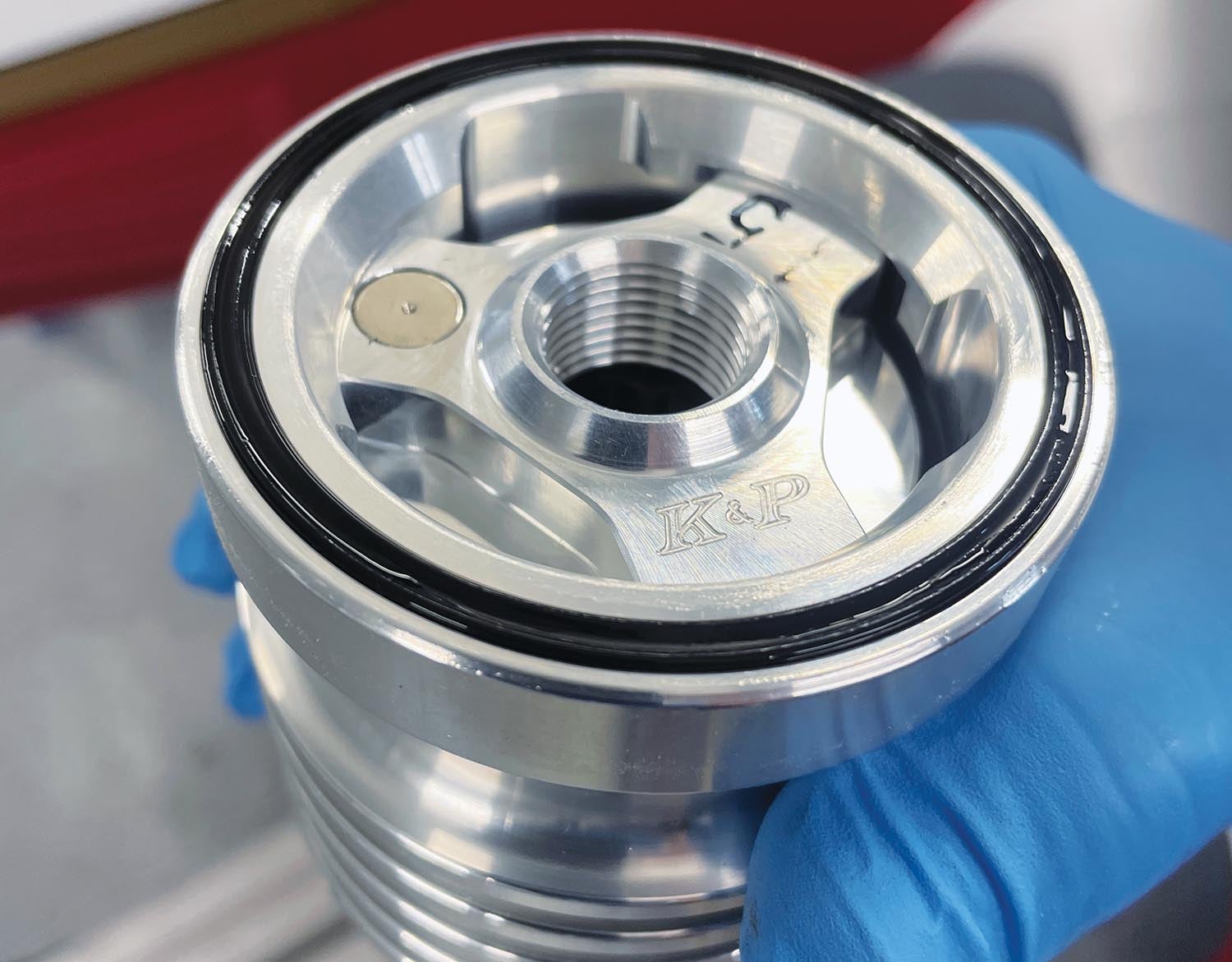

The interface end of the filters shows that the seal on the permanent filter is smaller—but it is an X-shaped O-ring, providing two sealing surfaces (left). Oil flows into the filter around the edges and out through the center. The 8110-2 filter style has a nipple installed in the filter (right). You need to purchase these separately for the S-15 filter, and install it with some red Loctite to adapt to your engine.

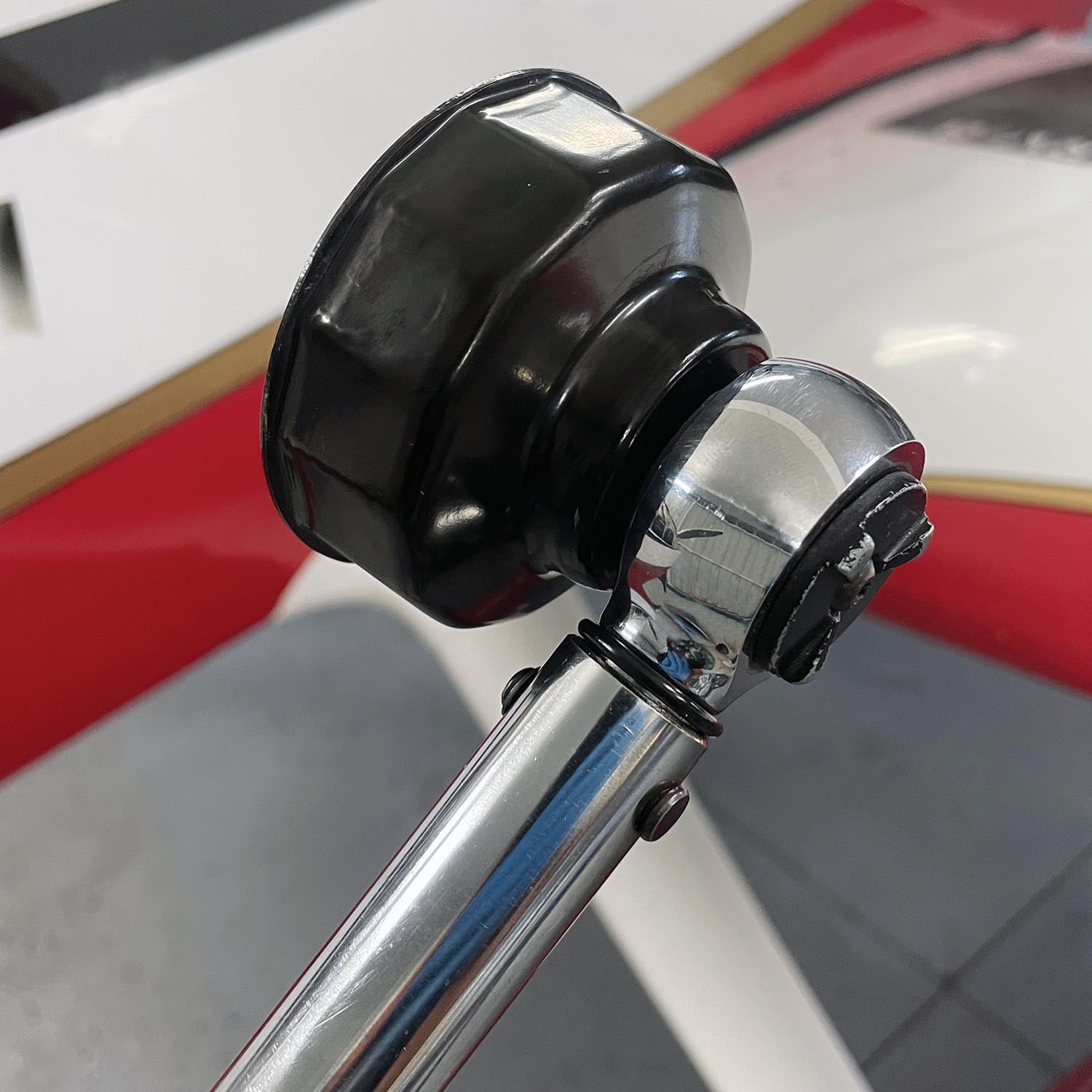

The cup wrench fits on the end of your torque wrench for easy filter installation—K&P calls for 18–20 foot-pounds of torque.
Other features of aviation oil filters are external, including a large (usually 1-inch) hex nut on the end to help you torque them without a strap wrench, and holes with which to safety wire the filter to the engine. Aircraft oil filters are safety wired because they have always been safety wired—or so it seems. This is another thing hotly debated on homebuilder forums, and this author falls on the side of, “If there is a hole why not safety wire it? And if there isn’t a hole, there is one on the engine—so why not have or make a provision on the filter?” The Challenger aviation filters have both the nut and the safety wire holes. The K&P filters marketed to the automotive and motorcycle world generally do not have either—but it is very easy to add holes in the top-most cooling fin, and these units come with a special “cup wrench” that mates to a 3/8-inch socket drive to make installation easy. Just don’t lose the cup, or you’ll be using a strap wrench.
One additional feature on the K&P-manufactured filter elements is a small high-strength magnet designed to pick up ferrous chunks from the oil. Magnetic drain plugs have been a thing for years—this is just a variation on the theme and probably not a bad idea, especially if you have reason to believe your engine might be shedding bits of steel or iron.

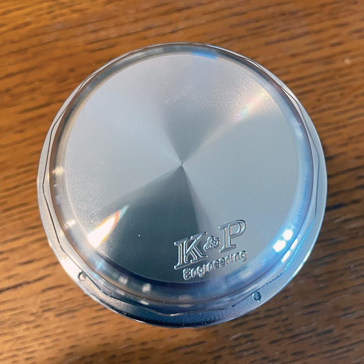

The only permanent filter intended specifically for aviation use is the one designed and marketed by Challenger. Challenger does not currently sell direct to consumers, but rather through a dealer network, probably the largest dealer being Aircraft Spruce. Because of the shortage of disposable filters in 2022, Challenger told us that they were having a difficult time keeping up with demand, but were doing what they could to increase their output.
permanent oil filter 07
The installed filter is significantly smaller than the disposable that it replaces. Whether or not the fins help cooling is debatable, since there is little airflow behind the baffles.
In the same way that many home-builders have used automotive filters on their Lycomings for years, many homebuilders have been purchasing the K&P-branded filters from various sources. The fact that K&P makes the Challenger filters has been used by many to assert equivalency, but as noted a little ways back, the filter element in the Challengers has a finer grid than the stock K&P product, which partly explains the price difference. It also should be noted that there have been a number of reports from homebuilders who had their orders canceled when K&P found out that the filters were going to be used on aircraft. Some manufacturers are funny that way—which is why, when you go to AutoZone to buy a Denso alternator, you must weave the story that it is for your beloved ’98 Suzuki Samurai and not your homebuilt airplane.
When it comes to commerce, some builders will seek out the cheapest solution and some will decide it’s more important to support two aviation companies (Challenger and the distributor/retailer) for what amounts to a difference equivalent to 20 gallons of avgas. That said, if you want the K&P, you’ll need the S15, which is a 48108 equivalent right off the shelf. To replace a 48110, you’ll also need a ¾-16 nipple for about $8.

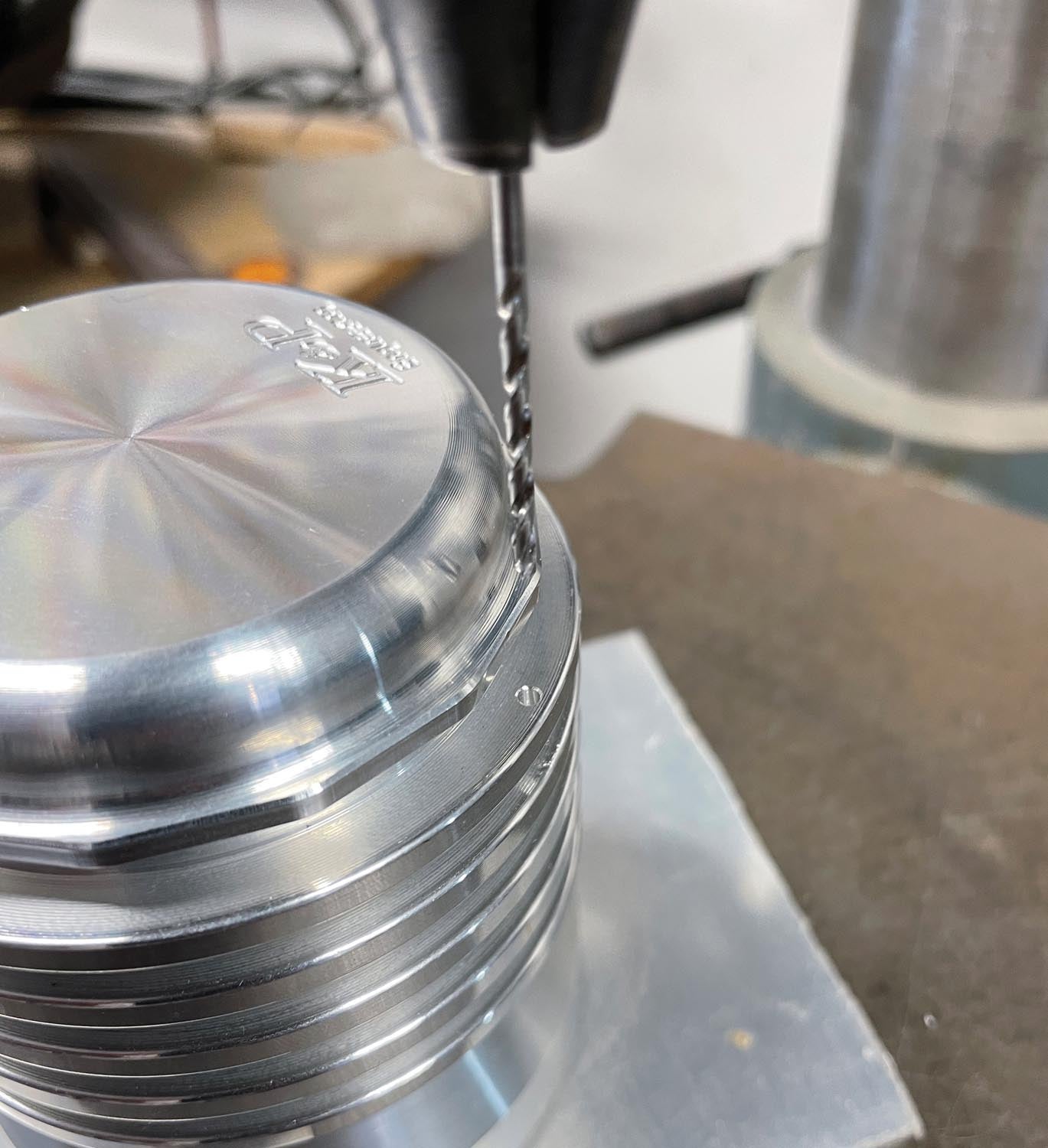

The standard K&P filter housing is not drilled for safety wire—this is easily accomplished using a #50 drill in your drill press.

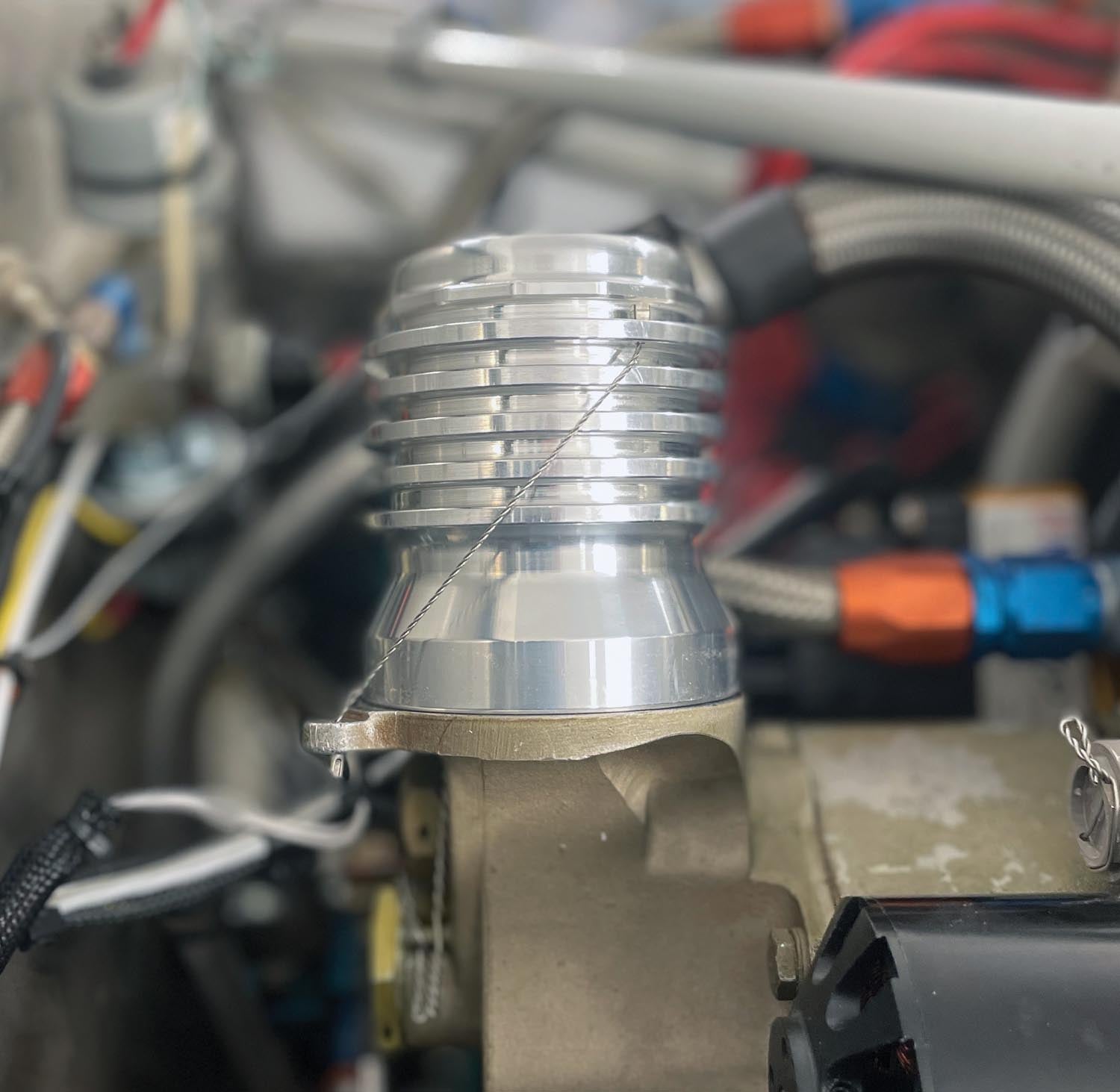

Installing the permanent filters is simple: Spin off the old filter and spin on the new one. Torque to the spec that comes with the filter, using the hex nut on the end or the cup tool, and safety wire. If you need to add the safety wire holes, it’s simple to drill a #50 hole in the outermost cooling fin. We drilled four in ours, just to give us various clockings. Note that the permanent filters come with an X-shaped O-ring. The K&P units we received came with a spare—we have read reports of folks using them up to 10 times, and also those who replace them every other oil change. Do what you feel comfortable with.
So what do the engine manufacturers and/or the FAA say about the permanent oil filters? Let’s start with the FAA. They have issued an STC for the Challenger filter, so they can be installed on virtually any aircraft with a Lycoming or Continental engine. Not that we need an STC in the Experimental world, of course. But clearly Challenger has proven to the FAA that their filters do the job up to acceptable standards.
permanent oil filter 03
We drilled four holes for safety wire in our filters so that we had options, depending on where they snugged up.
