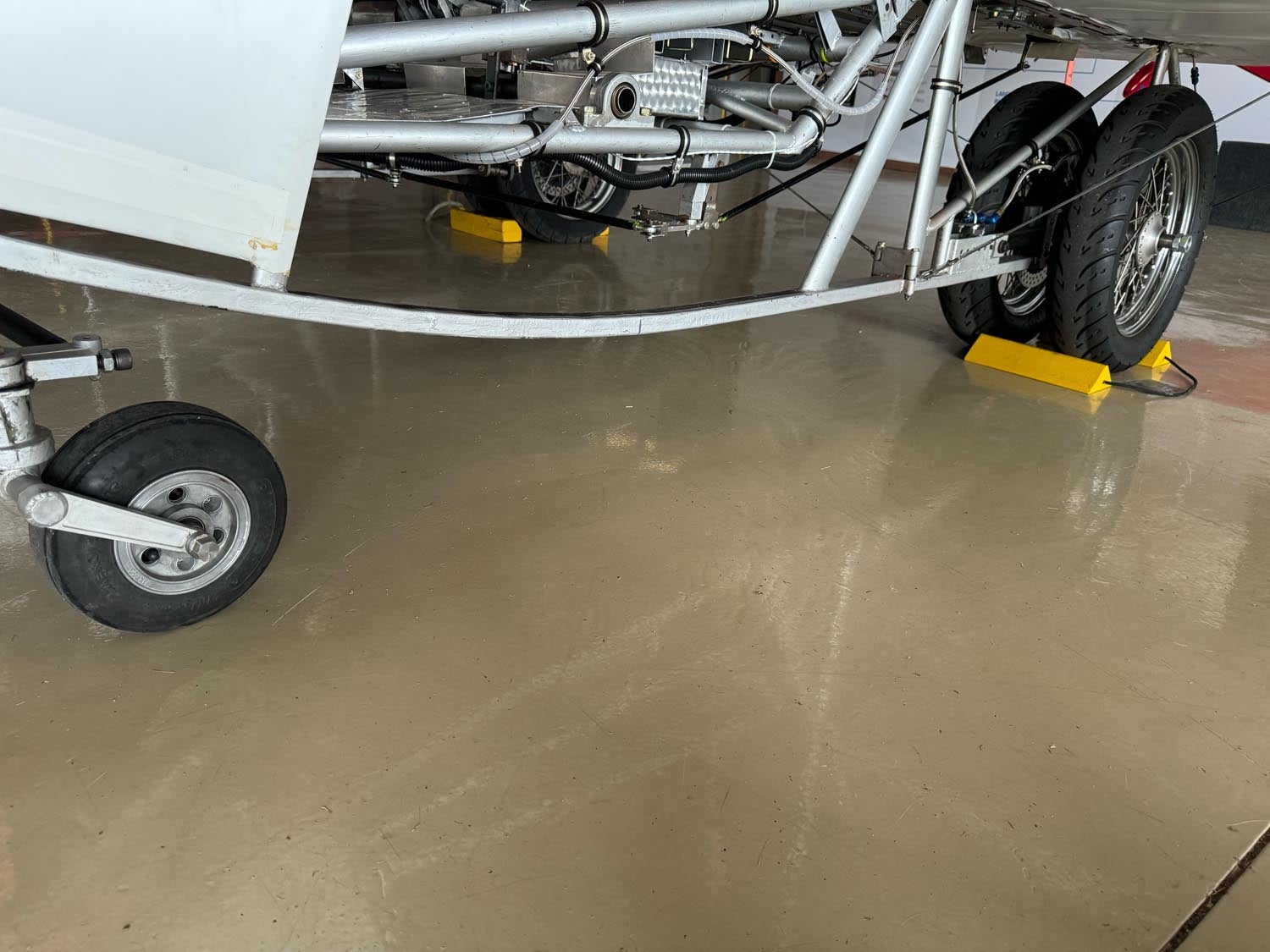

The main wheels are motorcycle rims, tires, and brakes.
