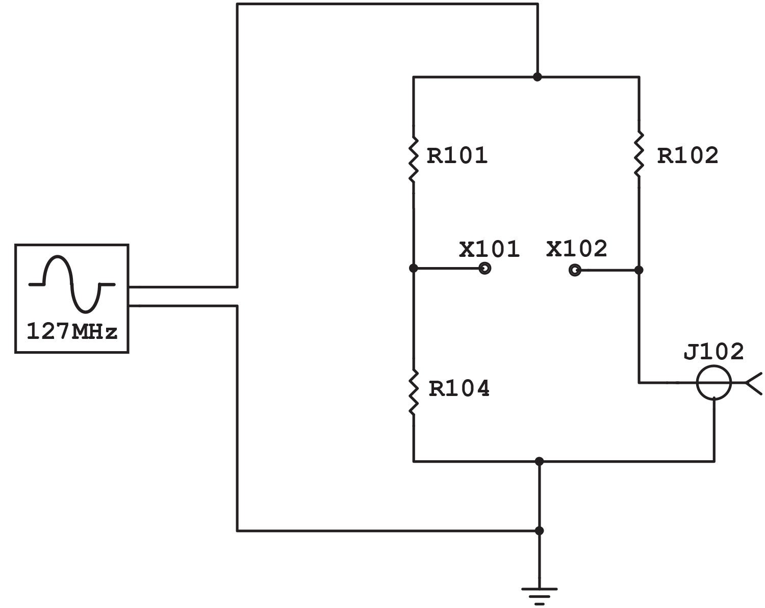

Wheatstone bridge VSWR detector
The schematic of the Wheatstone bridge VSWR detector. All 51-ohm resistors must be capable of handling the power of the “signal generator,” which is a small handheld transceiver. Also, the resistors must not be wirewound, but must be metal or carbon film.
What does this mean for us? It seems that the clever RF engineer who designed your radio took the fairly low resistive part of the transmitter transistor output through a fairly lossless capacitor-coil (inductor) combination transformer up to 50Ω output. This means that the couple of ohms of true output resistance is the only lossy item, and that most all of the power will be consumed and radiated at the 50Ω antenna port. Clever, those RF guys. And you get maximum power into the antenna where the 50Ω radio matches to the 50Ω antenna.
VSWR Heaven 03
Redrawing the Wheatstone bridge. Note that the four “arms” of the bridge are set up in a balancing act to detect imbalance at J102.

VSWR is a two-part measurement…How much do we have coming down the line and how much is bounced back? There are two main ways to measure this, and they should come to the same number, no matter how you do it.

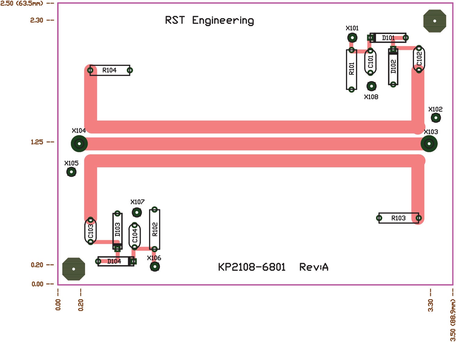

One is the “reflectometer” method. You send a transmit power down a calibrated microstrip line with two calibrated lines to either side of it. One of the lines measures the forward power (or the voltage corresponding to the power injected into the line by the transmitter) and a parallel line measures how much of that power is reflected down the line by the antenna. Power forward divided by power reflected gives you a measure of VSWR.
The other way is the Wheatstone bridge method. Wheatstone bridges consist of four “resistors.” Two of them are for balance, one is for standard, and the fourth is the variable to measure against the standard. Again, the bridge gives you the power transmitted and the power reflected, which is the measure of VSWR.

These are 50-ohm impedance lines. One is for the “main line,” straight from the signal source (transmitter) to the antenna. One line is for forward power measurement, and one line is for reflected power measurement.
Me? I’m happy either way, but I will point out that the reflectometer requires some PC board “microstrip” work to make the measurement, and the Wheatstone bridge requires plain old resistors. The upside is that the reflectometer can be done with quarter-watt resistors, and the Wheatstone requires resistors capable of handling all the power that your signal generator can provide.
Oh, the signal generator? You’ve probably got one. It is called a handheld portable, capable of testing the antenna at the center and edges of the band. With a watt of power or so, you are working with volts of signal, more than enough to use a Harbor Freight $8 digital voltmeter as your measuring device.
VSWR Heaven 05
Note that almost the entire bottom of the board is going to come out metal to act as a ground plane for the arms of the reflectometer on the top of the board.
