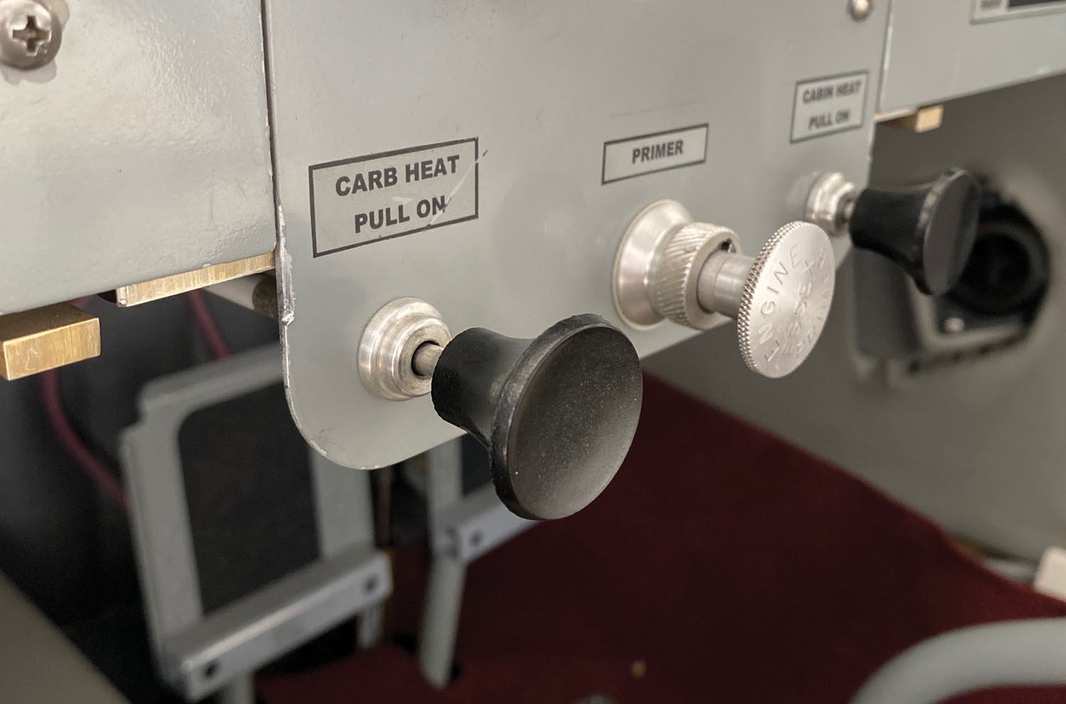

What do we have here? The carb-heat flapper was clearly sitting proud of the airbox floor, which means it was also open to the rear, admitting heated air to the carb at all times. I went over to the linkage and noticed that the cable was tight. Inside the airplane, the control was hard against the stop. A few minutes later, with a minor adjustment, the leading edge of the flapper sat flush against the floor, and I had an appropriate amount of control gap at the panel.
I still had doubts it was that simple. Could the flapper be so influential? Was it an airflow disturbance or the heat, or both? Had I just chased a ghost? The next flights proved it; the EGT spread was nearly gone, Number 4’s CHT came down into the pack and, as an added bonus, the engine seemed stronger now that it wasn’t inhaling a bit of heated (and, I daresay, unfiltered) air all of the time. As further proof, I could induce the anomaly by pulling on a bit of carb heat. Perhaps ironically, the more heat I applied, the less severe the effect. Meaning the flapper just happened to be at or near the worst-possible setting to make Number 4 run lean. Just my luck!
Carb Heat Control
Engine controls all need a certain amount of cushion when fully engaged to ensure the mechanism is the stop and not the control itself.
Moral of the story? Each engine control needs to have a bit of cushion so that whatever it’s managing hits the limits  at the device and not the control. This very basic mechanical concept eluded me—and, it has to be said, at least a few of those who came before me with this airplane. The effects were no doubt obscured by poor instrumentation—it’s easy to think all is well and that, maybe, this just isn’t a particularly energetic O-320. What you don’t know…
So, in case you’re wondering, I did re-check every control in the airplane after this and made some other very small adjustments—including to my sense of “what else could be wrong?” If you allow it, the (re)learning never stops.
