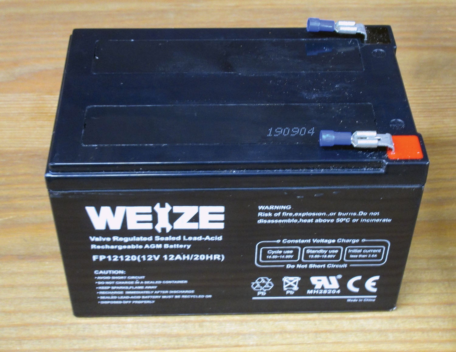

A small 12-volt, 10-amp-hour battery. This one is what I use to keep the hangar radio going using the small 1.5-watt (100 mA) charger on a constant float charge.

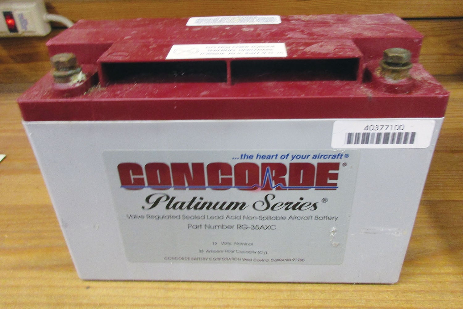

The workhorse of the hangar power supply: This 12-volt, 35-amp-hour battery will keep the lights on for a week’s work in the hangar, including a small 12-volt droplight for close work inside the aircraft.

    The 35-amp-hour battery that was resurrected from near death by the Harbor Freight recharger we talked about in the May 2018 issue (“Harbor Freight Leads the Charge!”). Used in parallel with the workhorse above, it gives nearly two weeks of full-light workdays or a couple hours of work with the compressor used for engine leak-down testing.

  • The “hangar radio” will generally be a 12-volt junker airplane radio that has a 110-volt battery supply for power. We can now bring that radio back to 12 volts directly.

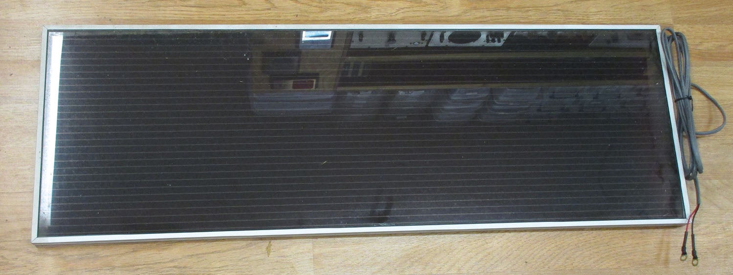

This 25-watt solar panel produces about 2 amps output in full sunlight or a bit less on a cold winter day in moderate sunlight.

It is also true that solar panels do not deliver constant voltage or current. The voltage and current they deliver is totally dependent on how much sunlight falls on the panel, the temperature and the cloud cover. So, it is dependent on the engineer to design a 12-volt battery charger that takes a wildly varying amount of wattage (volts x amps) that the solar panel delivers and converts this power efficiently into volts and amps that the battery can store. In general we call this a constant-power circuit.
