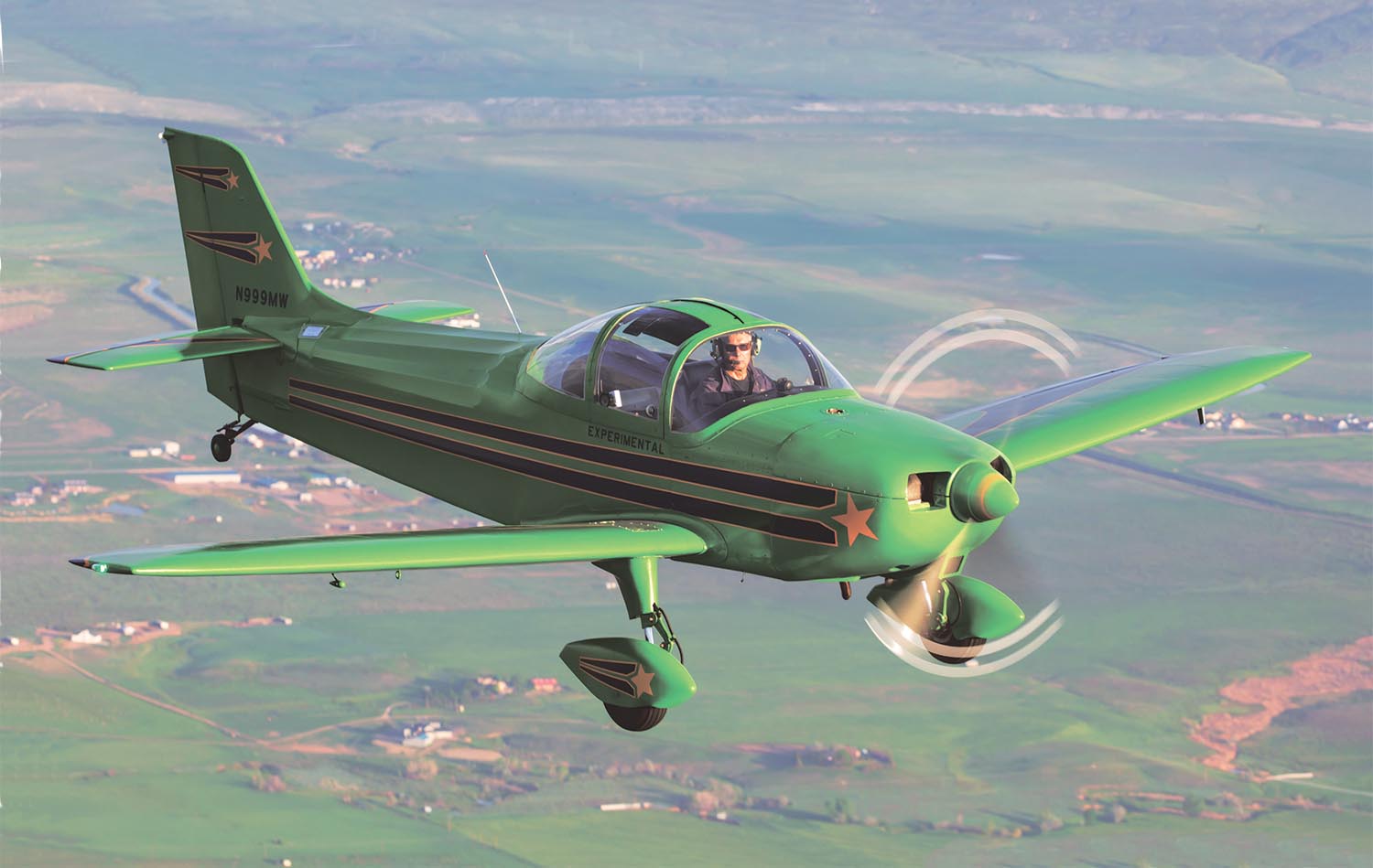

Emeraude 08
Powered by an O-320, this French beauty scoots along with respectable performance.
