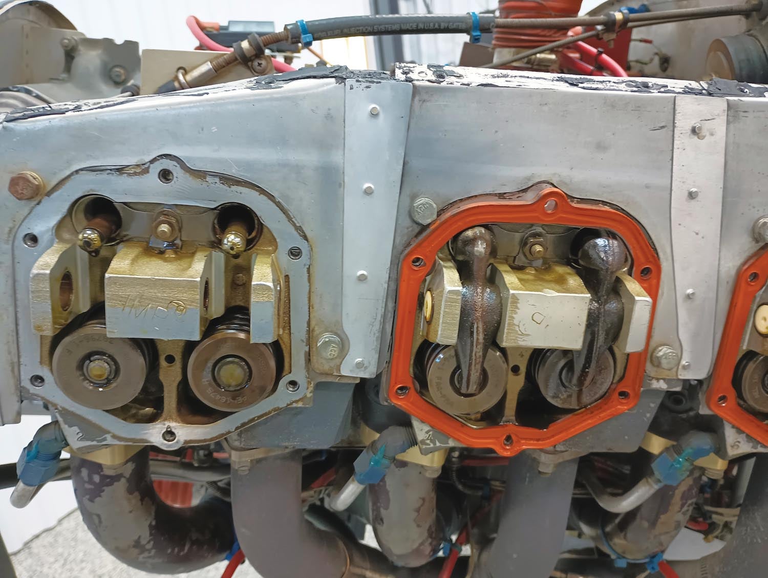

Getting a Lycoming IO-540 ready for its wobble check, with valve covers and one gasket removed.

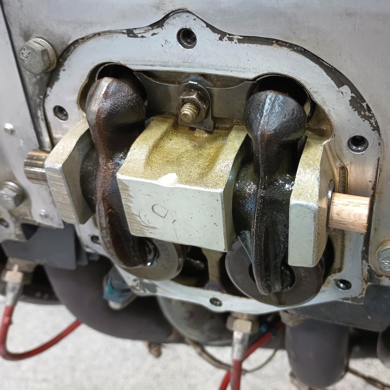

Close-up of the cylinder head (right), with the rocker arm shaft partially driven out to the left.
After removing the cowl, remove one spark plug from each cylinder, then remove each of the valve covers. You may want to keep an oil drip pan or some old cardboard under the engine, as oil is likely to spill out as each valve cover is removed.
With the valve covers off, the rocker arms, rocker arm shaft and valve stems/springs are revealed. On parallel-valve engines the rocker shaft runs through both rocker arms. The rocker arms are pushed up by the pushrods, causing them to rock and press down on the ends of the valves. The first step in removing the rocker arms is to remove the rocker shaft. However, before removing anything, take careful note of which rocker arm is used for the exhaust and which is used for the intake. You will want to ensure that the correct rocker arm goes back into the correct original position. Depending on the engine model, the arms may not be the same. They should have a part number stamped on the side to aid in identification. You might want to write this number down before removing them.

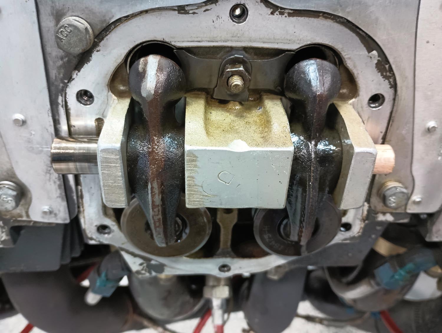

A wooden dowel is being driven in from the right, pushing the rocker arm shaft out to the left. A soft dowel keeps you from damaging the bushings inside.
Turn the propeller by hand until the piston of the cylinder you are working on is close to top dead center on the compression stroke. Confirm this by feeling for compression at the spark plug hole or by pressing on the rocker arm above the pushrod. There should be a small amount of movement, indicating that the cam lobes are away from the lifters and the pushrods are not placing any pressure against the rocker arms. Back the propeller up about 30° and stuff a rope into the cylinder.

If the rocker shaft is tight, it helps to tap the dowel with a hammer. There is little room to swing the hammer, so turning it sideways may be necessary.

The rocker arm shaft has been shifted left, allowing the rocker arm to be removed.
Remove the rocker shaft end caps using a dental pick. It may be possible to press the rocker shaft out by hand. If not, you can attach the Valve Wizard tool to relieve any spring pressure from the rocker arms and/or drive the shaft out, tapping gently with a hammer on a wood dowel. On my engine, 1/2-inch dowel was the right size: a little smaller than the rocker shaft outside diameter, but large enough to catch the rim of the hollow shaft. If you really want to get trick, you can 3D print a plastic cap to fit into the end of the rocker arm shaft (see “Tools and Parts” below for details).

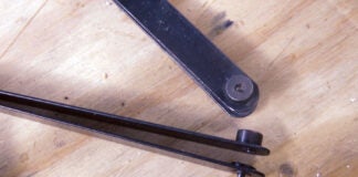

With the rocker arms, springs and keepers out of the way, Cool Tool #2 can now be used. This is the fixture tool that will hold a dial gauge to check the amount of wobble at the end of the valve. Included with the tool is a short stem that connects onto the end of the valve stem. Connect this stem, then pull the prop back far enough so that the valve can be pushed partway down into the cylinder. This moves the valve so its wiggle won’t be limited by the valve touching its seat and lines the tool stem up with the dial gauge, held in place by the fixture tool. Using finger pressure, push the stem away from the dial gauge, zero the gauge, then push the stem toward the dial gauge. The total amount of movement should be within the limit for your engine as published in Lycoming Service Bulletin 388C. On my IO-540, the limits for total movement are 0.015–0.030 inches.
If the wobble check passes, then the disassembly process can be reversed. However, if there isn’t enough wobble, the trash in the valve guide will need to be cleaned out with a reamer.
