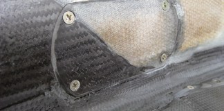

Kuykendall considered going the LSA route (for which a glider category exists), but there is simply too much paperwork and compliance for his small company, HP Aircraft, LLC, to deal with at this stage. Nevertheless, he guarantees that the HP-24 will qualify for Experimental/Amateur-Built. “I will do whatever it takes to ensure that builders are in compliance with the 51% rule. Early kits will naturally require more builder involvement, but as we move forward toward more prefabricated parts, we will work with the FAA to ensure the builder is still doing the major portion.” For example, bottom wingskins will be molded with removable panels that allow the builder to install the integral control hardware for flaperons and ailerons. This work traditionally requires lots of cure-cycle time for individual parts (i.e., needing to wait for a part to cure before proceeding to the next step), so it is more efficiently done at the builder’s home shop, rather than at Kuykendall’s shop. And for Canadian E/A-B rules, which require inspection before closing up major assemblies, Kuykendall will provide fuselage halves rather than the prebonded fuse that U.S. buyers will receive.
