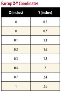

Step 2: Copy the Plotted Coordinates to a Spreadsheet
3d bose 02
Figure 2: The first few plotted points defining the shape of the bracket.
Using the X-Y coordinates from Step 1, a simple two-column spreadsheet was prepared. The plotted grid points were in whole numbers, but the graph paper was marked in 1/10-inch squares, so dividing the plotted numbers by 1/10 provided the X-Y coordinates in decimal inches. These were used to populate the spreadsheet. In total, 41 points were plotted, starting at the lower left corner of the bracket, traveling up the outside edge, then around the lower right corner and back around on the inside edge until getting back to the starting point, making a complete plot describing a closed figure. Figure 2 shows the first few points in the spreadsheet.
