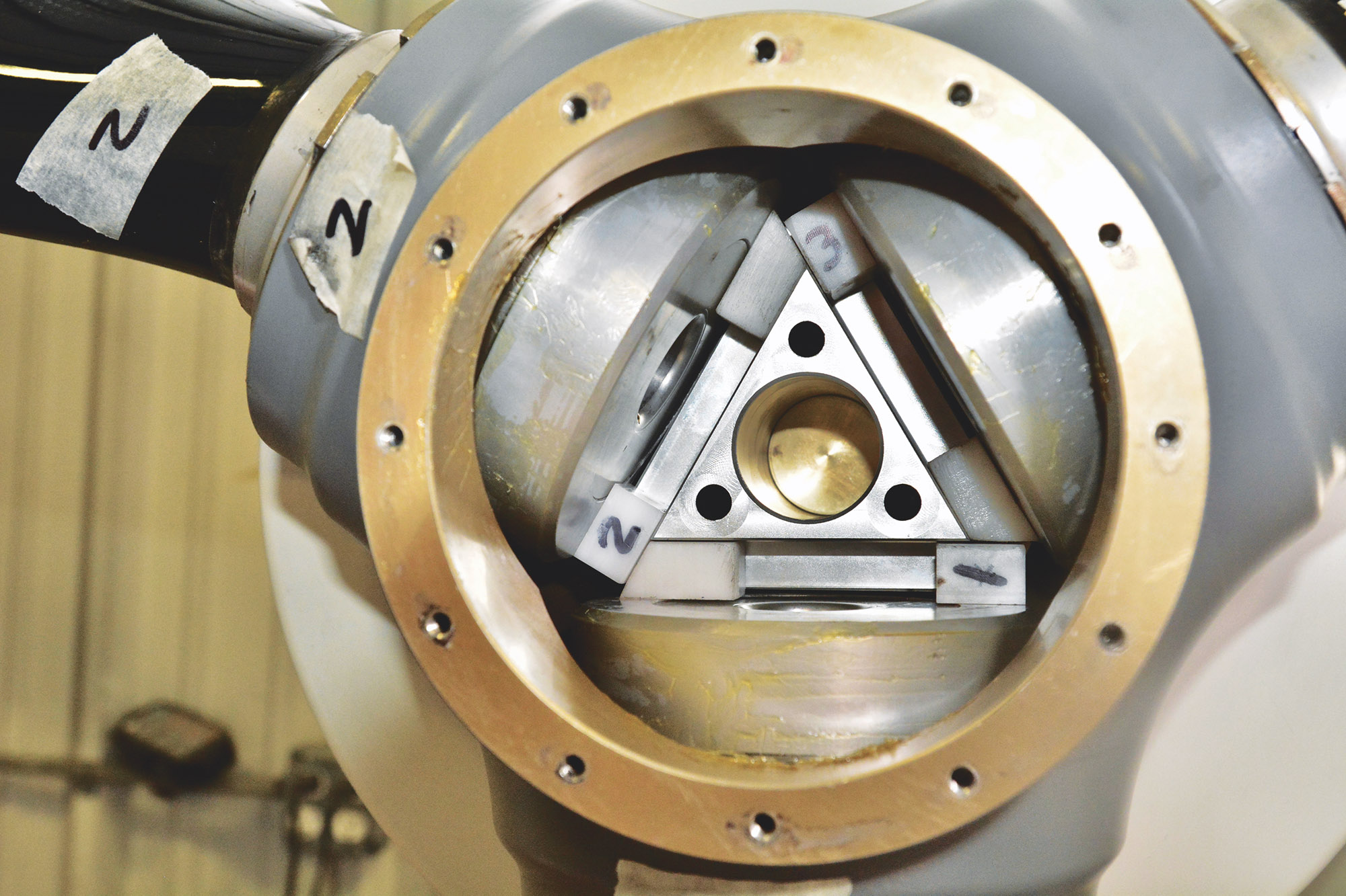

Inside the constant-speed prop hub. For most, oil pressure adjusts blade pitch. It’s well proven but more complicated and heavier than a fixed-pitch setup.

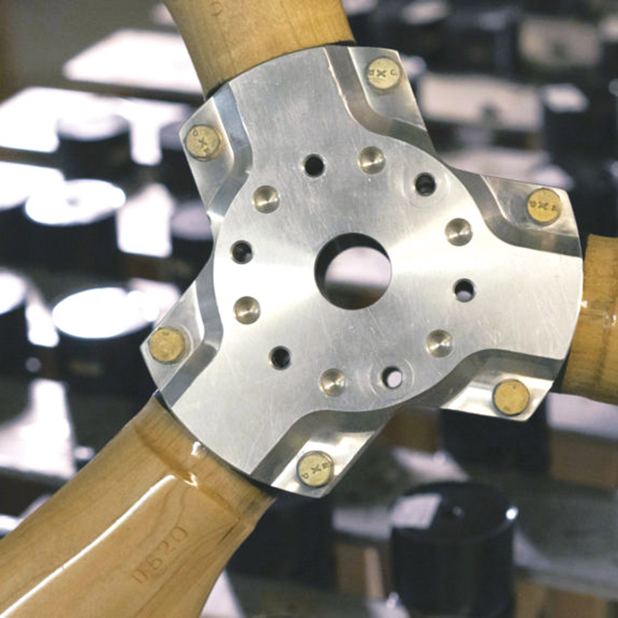

The Tonini brothers, Alessandro and Paulo, operate GT Propellers in Riccione, Italy, producing natural wood/composite propellers with removable blades for easy shipment and replacement. The extensive GT product line extends from 60-hp lightplanes to 2500-hp Merlin engines in Spitfires, even high-altitude turbine-powered drones. Alex Tonini says GT is delivering propellers regularly to the U.S. and worldwide. GT has EASA and ENAC certifications.

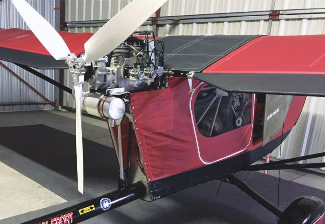

Coming up on a quarter-century of supplying electric constant-speed propellers from their Auckland, New Zealand, factory, Airmaster makes two- to five-blade hub designs. Martin Eskildsen says they now have a new DSD (Digital Servo Drive) that features a brushless motor capable of operating at a quick 5° per second, available on all Airmaster models. The pitch range goes from -20° to +85°, for feathering and reversing. Airmaster offers props capable of handling 50- to 350-hp outputs.
AXSport Aviation
Airmaster Propellers

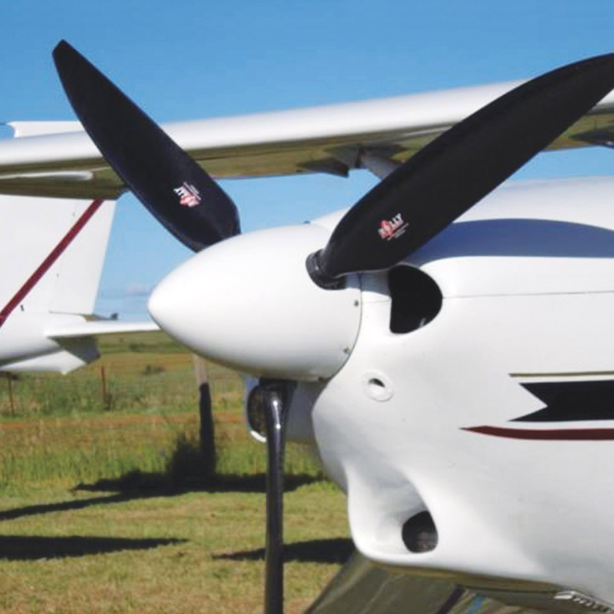

Bolly Aviation
Bolly Prop
Bolly Aviation
Bolly Aviation’s Peter Tapp reports that nothing has changed for 2025 in their ground-adjustable carbon fiber propeller line, still centered on the LSA and ultralight market. Furnished in two-, three- and four-blade styles, their Optima series props come in a Series 3 version for reduction-drive applications and a Series 5 for direct-drive engines. Bolly is headquartered at Virginia in South Australia.

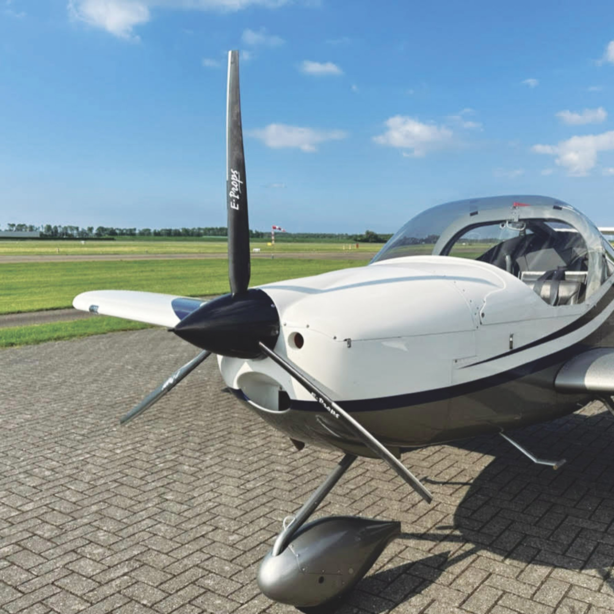

Produced in southeastern France, the E-Props propeller line is represented in the USA by Evolution Aircraft Inc. at Zephyrhills, Florida. The carbon fiber ground-adjustable E-Props are reportedly the lightest available, with a 68-inch model weighing only 4.6 pounds. Their ESR feature claims to allow only a 100 rpm rise from zero to 125 mph on a Rotax 9-series engine. Larry Mednick also reports E-Props now has a specifically made RV-12 prop assembly with a much more robust pitot system using ball bearings that does not rely on the spinner cone to support the pitot tube. Climb is improved by 200-300 fpm and cruise speed is increased by 6-9 mph. TBO is set at 4000 hours.

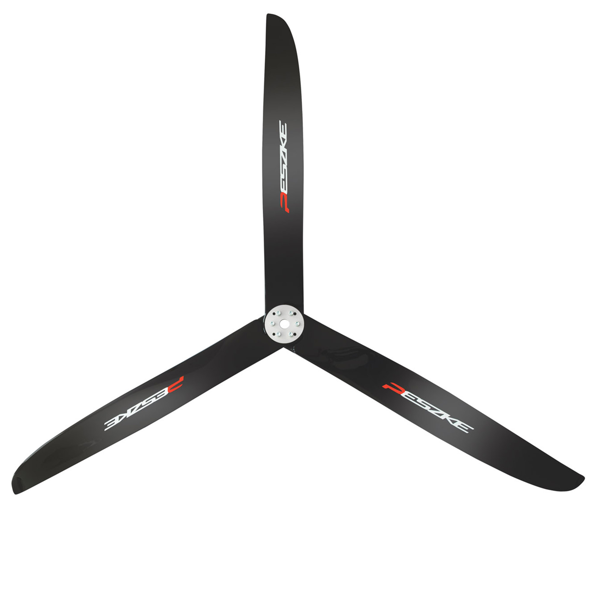

Peszke S.C.
PeszkePX09
Peszke S.C.
Peszke Propellers is completing a 25-year history of producing composite-blade ground-adjustable propellers in its factory located at Korczyna in southeastern Poland. Part of 2XP Technologies Sp, the company builds carbon fiber three-blade props capable of handling up to 160 hp, its B-Line products. Other offerings are an F-Line folding propeller for motorgliders and P-Line fixed- and adjustable-pitch propellers for ultralights with up to 60 hp.
