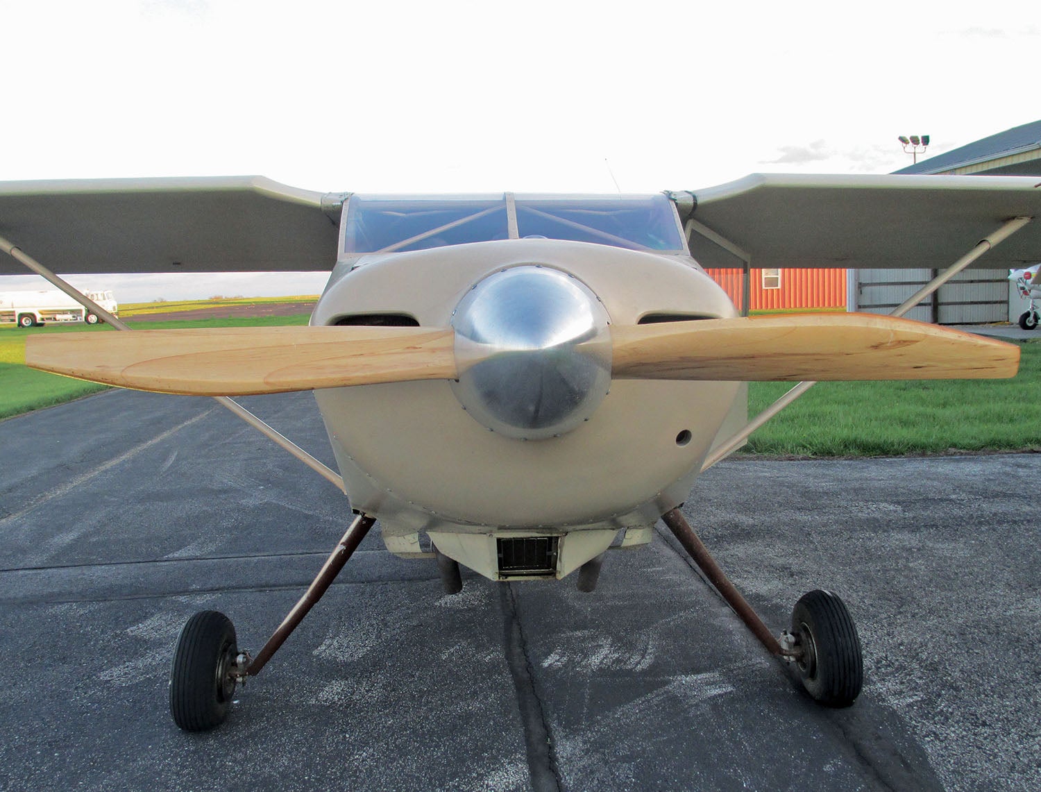

Culver prop on Pietenpol
Culver Props
Culver Props
Culver propellers, formerly associated with Valley Engineering in Rolla, Missouri, since 2001, is now operating on its own since Valley Engineering has closed down. Alaina Lewis’ small factory has been relocated a few miles down the road and still turns out custom wood propellers for the Experimental aircraft market. They specialize in vintage profiles, popular with WW-I replica airplane owners. Maple, cherry, mahogany and birch woods are used; the two-blade fixed-pitch props are suitable for installations up to 300 hp.

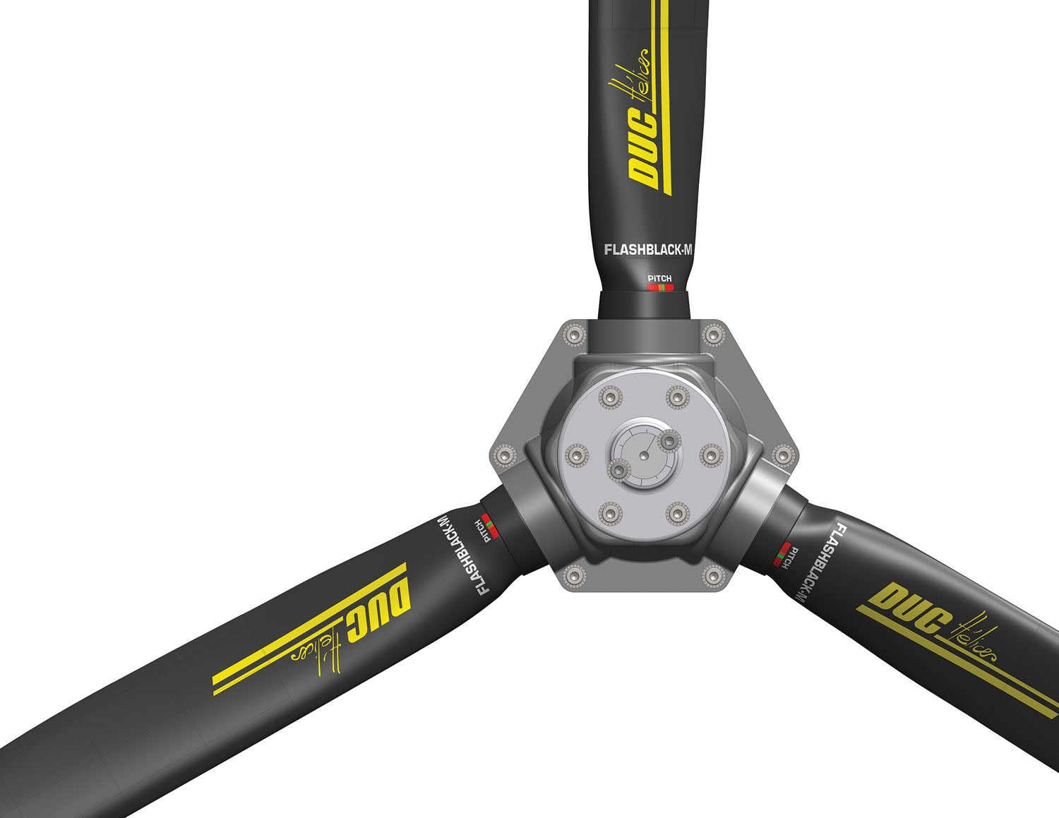

DUC FLASHBLACK
DUC Hélices FLASHBLACK
DUC Hélices
DUC Propellers USA in Sebring, Florida, opened in January 2019, a subsidiary of propeller and rotor maker DUC Hélices, which is located in Lyon, France. Its EASA-certified forged-carbon composite propellers are targeted for Experimental and ultralight aircraft of up to 180 hp, along with helicopter and gyrocopter rotors. DUC Hélices is now offering ground-adjustable, in-flight variable-pitch and constant-speed propellers.
DUC’s SWIRLBLACK-3 Hydraulic is termed the world’s lightest three-blade constant-speed hydraulic propeller, along with the FLASHBLACK Hydraulic, which comes as a two- or three-blade configuration with an Inconel leading edge. The company also offers 100% electric variable-pitch propeller systems with carbon/titanium blades, available in two-, three-, four- or five-blade models.

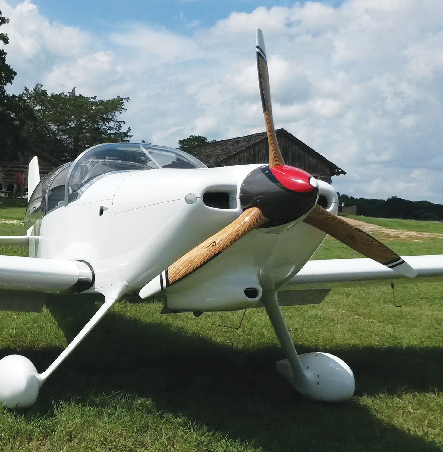

PerformancePropeller on RV 6
Performance Propellers USA, LLC
Still located in Donie, Texas, Performance Propeller’s Frank Johnson says he’s “still building the best wood props available.” Each of his props are custom made, and the customer is welcome to try their new propeller out to verify rpm, sending it back for tweaking if required. After that, the final finish and rainproof leading edge is installed. Built of laminated wood, two- and three-blade Performance Propellers are available exclusively for Experimental and aerobatic aircraft up to 300 hp.

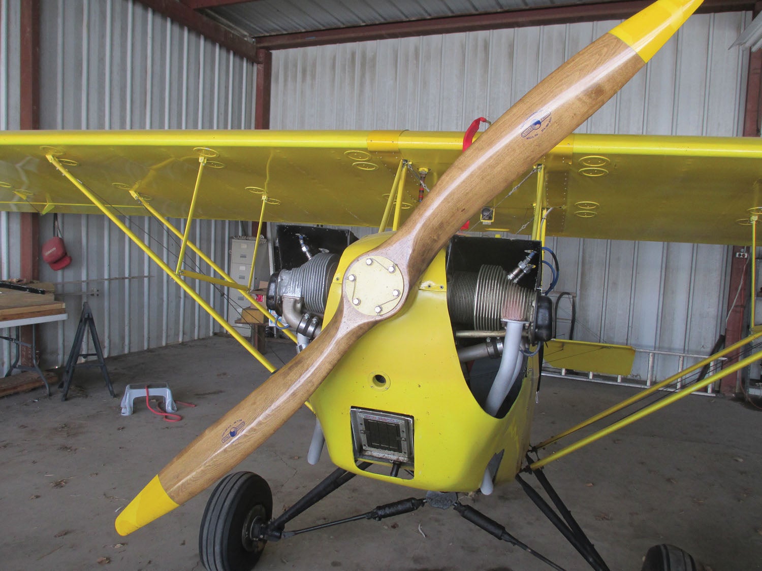

Sterba prop on Whittman Tailwind
Sterba Propellers
Edward Sterba Propeller Co.
Ed Sterba is still in the hand-carved wood propeller business, using maple, birch and cherry laminations with a urethane insert for leading edge protection. He does not have a website, but a web search turns up his basic information; he can be reached by email or phone. His Sweptback propellers are primarily designed for VW engine installations, which was his original focus, and the Race series are for Continentals and Lycomings used in RVs, Midget Mustangs and Long EZs, up to 200 hp. The latter have a curved leading edge and narrow tip profile.
