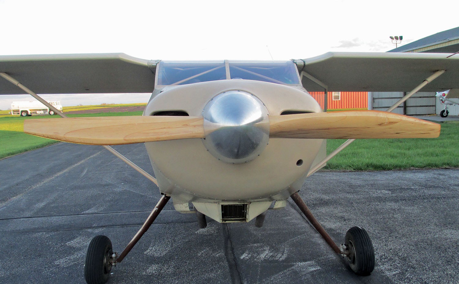

Sensenich wood
Sensenich Propeller Co.

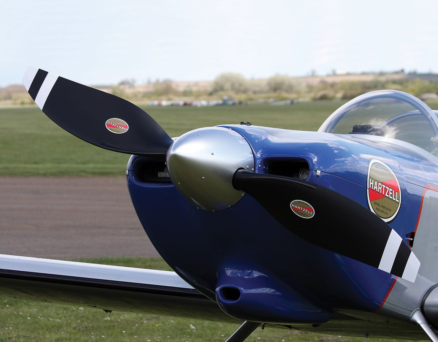

RV with 2 blade Hartzell composite
Hartzell Propeller, Inc.
Hartzell’s involvement with aircraft propellers dates back over 100‭ ‬years‭, ‬when the Hartzell and Wright families were near neighbors in Dayton‭, ‬Ohio‭. ‬From its beginnings with walnut fixed-pitch props‭, ‬Hartzell now supplies‭ ‬constant-speed‭ ‬propellers for a myriad of installations‭.‬
Hartzell Propeller offers a wide variety of propellers for the experimental and homebuilt market‭. ‬It is the leading provider of‭ ‬constant-speed‭, ‬variable‭- ‬pitch propellers to the global kit airplane community‭. ‬Hartzell’s props are compatible with a wide range of engines‭ ‬and are available with both metal‭ ‬and composite blades‭. ‬Continuing to innovate and bring new technology to market‭, ‬Hartzell has recently added a three-blade‭ ‬“Raptor‭*‬”‭ ‬hub propeller to its lineup of E/A-B products‭, ‬offering higher performance and weight savings‭. ‬
The latest product introduced by‭ ‬Hartzell is a new three-blade composite Pathfinder propeller optimized for‭ ‬backcountry operation‭, ‬developed in‭ ‬conjunction with CubCrafters and Lycoming‭. ‬At only 44‭ ‬pounds‭, ‬it provides a lightweight three-blade alternative to the‭ ‬Trailblazer series‭.

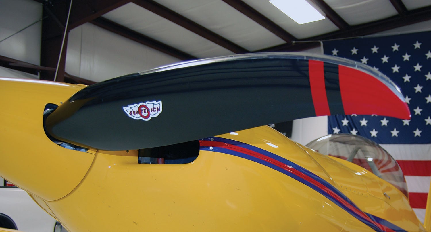

Sensenich Propeller Co‭.‬

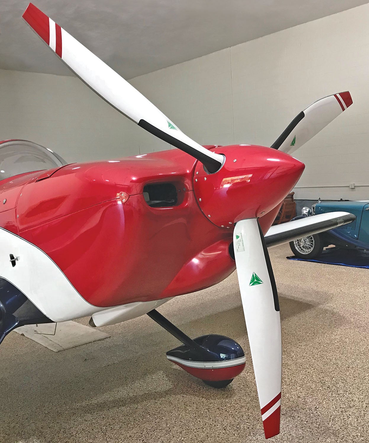

Sensenich Composite
Sensenich propellers were born in the heart of the Great Depression in 1932‭, ‬and the original company headquarters is still located near Lancaster‭, ‬Pennsylvania‭, ‬where the firm began‭. ‬Its wood and composite propeller products now‭ ‬come from a Plant City‭, ‬Florida‭, ‬division‭, ‬while Sensenich’s metal propellers are built in Lititz‭, ‬PA‭. ‬The company supplies propellers for both certified and Experimental-category aircraft‭.‬
Announced at AirVenture 2019‭, ‬Sensenich has created a whole new line of ground-adjustable composite props‭, ‬swept-tip two and three-blade units that are designed for the O-320‭/‬O-360‭ ‬installations in Van’s RV airplanes‭. ‬The two-blade propellers are 68-72‭ ‬inches‭ ‬in diameter‭, ‬while the three-blade‭ ‬props are of 64-68‭ ‬inch diameter‭. ‬In addition‭, ‬a two-blade 74-76‭ ‬inch diameter Pitts propeller is available‭, ‬and a big 78-82‭ ‬inch thruster for STOL airplanes‭ (‬Bearhawk‭, ‬Super Cub‭, ‬RANS‭, ‬Zenith‭) ‬was introduced‭. ‬In both of‭ ‬the latter cases‭, ‬three-blade units were under development‭. ‬Bonded leading‭ ‬edges and Sensenich’s unique pitch‭-‬setting gauge are standard‭.‬

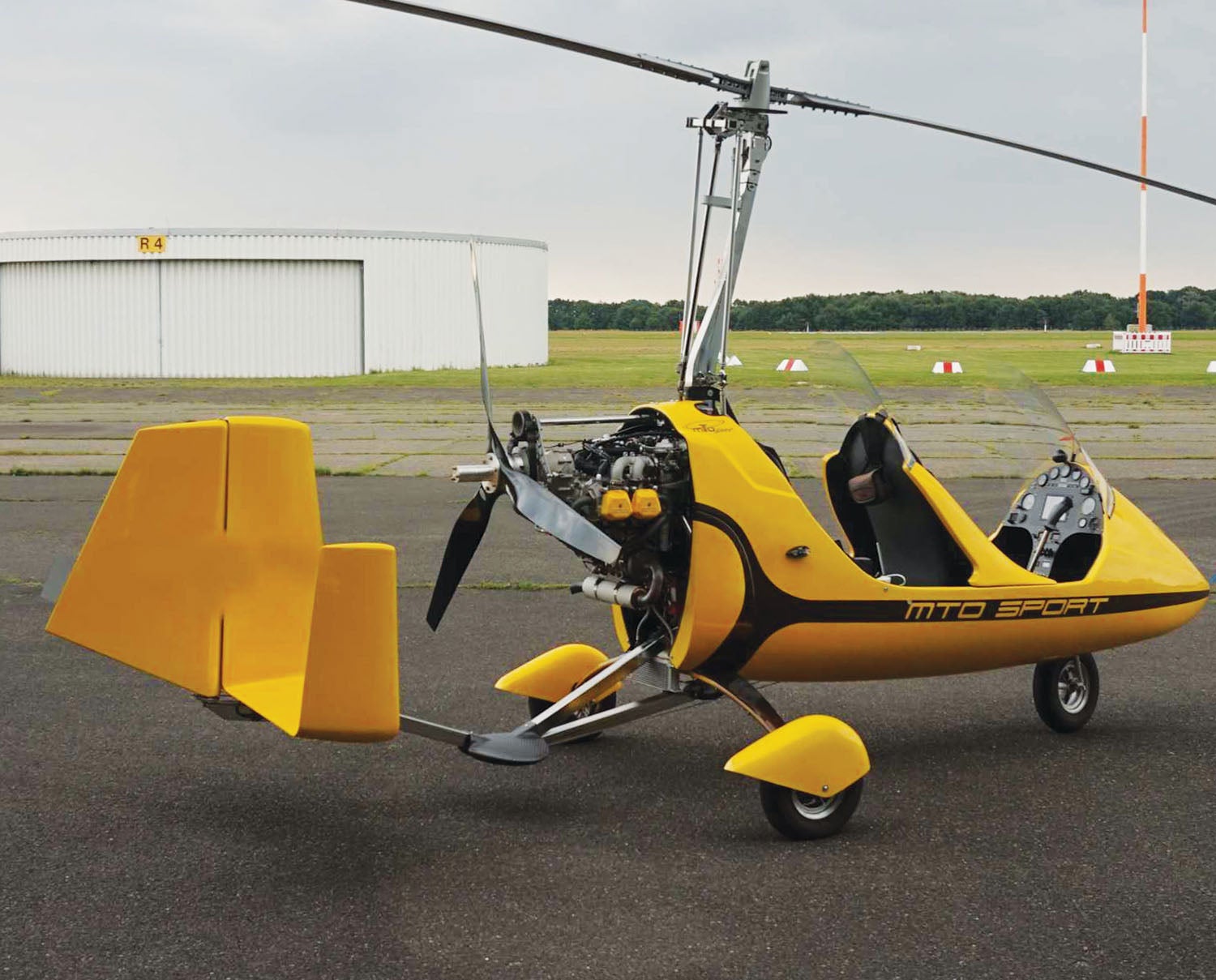

Ivoprop on Autogyro
Ivoprop Corporation
Ivo Zdarsky escaped from communist‭ ‬Czechoslovakia in 1984‭, ‬using an aircraft and propeller of his own making‭. ‬Since then‭, ‬Long Beach‭, ‬CA-based‭ ‬Ivoprops have become widely known for their imbedded torsion rod that allows pitch adjustment‭, ‬either on the ground or electrically in-flight‭. ‬Ultralight‭, ‬Medium and Magnum models are offered‭, ‬in two or three blade styles‭, ‬and there’s even a six-blade‭ ‬“X”‭ ‬system‭. ‬The Medium series propellers are for engines up to 100‭ ‬hp‭, ‬while the Magnum props can handle up to 700‭ ‬hp‭. ‬Blade construction is of carbon fiber composite‭, ‬finished with black gelcoat and a stainless steel leading edge‭. ‬

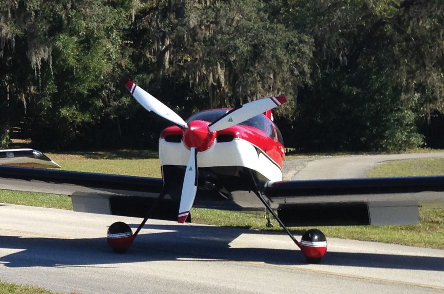

PerformancePropeller on RV 6
Performance Propellers USA, LLC
Performance Propellers‭, ‬based in Donnie‭, ‬TX‭, ‬offers two and three-blade‭ ‬CNC-cut laminated wood propellers‭ ‬for experimental and aerobatic aircraft‭. ‬Takeoff and climb performance‭ ‬is maintained without compromising‭ ‬cruise performance by optimizing blade profile and flexibility‭. ‬Each propeller is custom made‭, ‬and the purchaser can try the prop out and send it back for tweaking after verifying initial rpm‭. ‬The final‭ ‬finish and poured rainproof leading‭ ‬edge are then applied‭.‬
