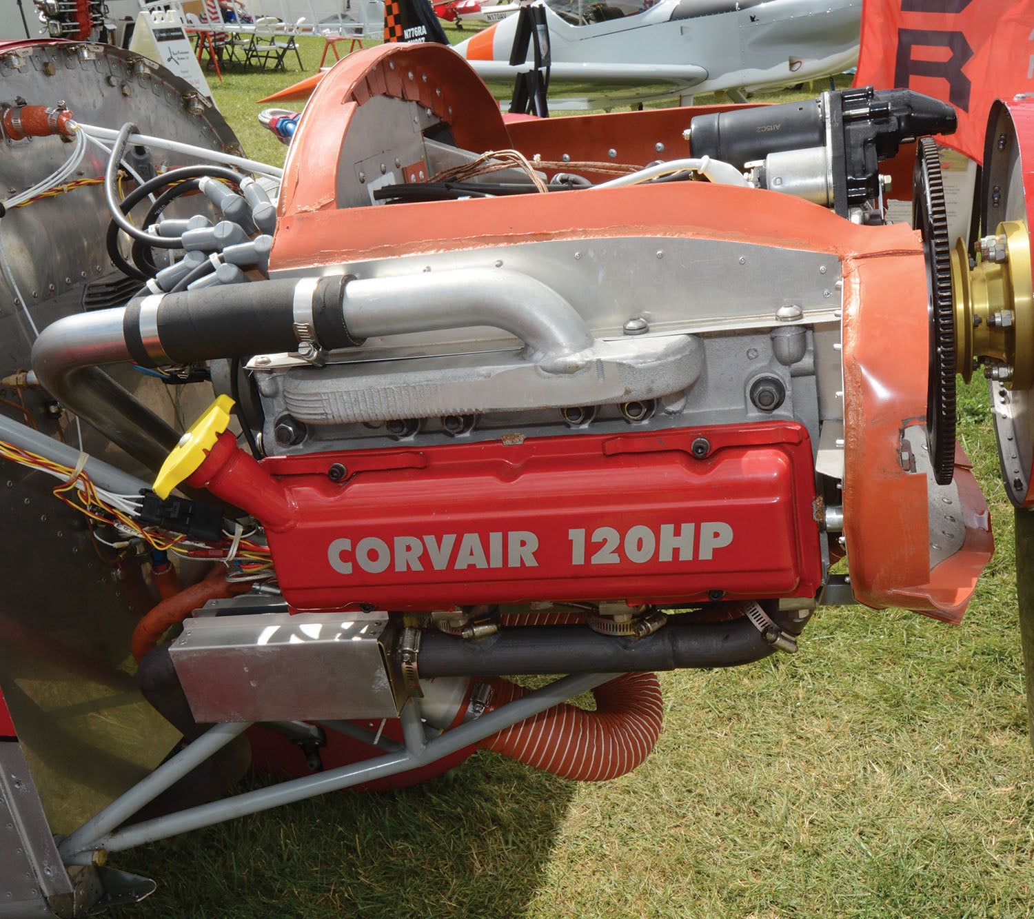

In the VW and Corvair engine market‭, ‬kit engines are still the norm‭. ‬These‭ ‬engines are aimed at the hands-on‭ ‬enthusiast who’s happy to assemble his‭ ‬engine and keep the cash that would‭ ‬have been spent paying the shop to do the same‭. ‬If you’re not that guy‭, ‬almost all such shops will assemble the engine for you for a fee‭, ‬so keep that in mind when comparing prices‭. ‬

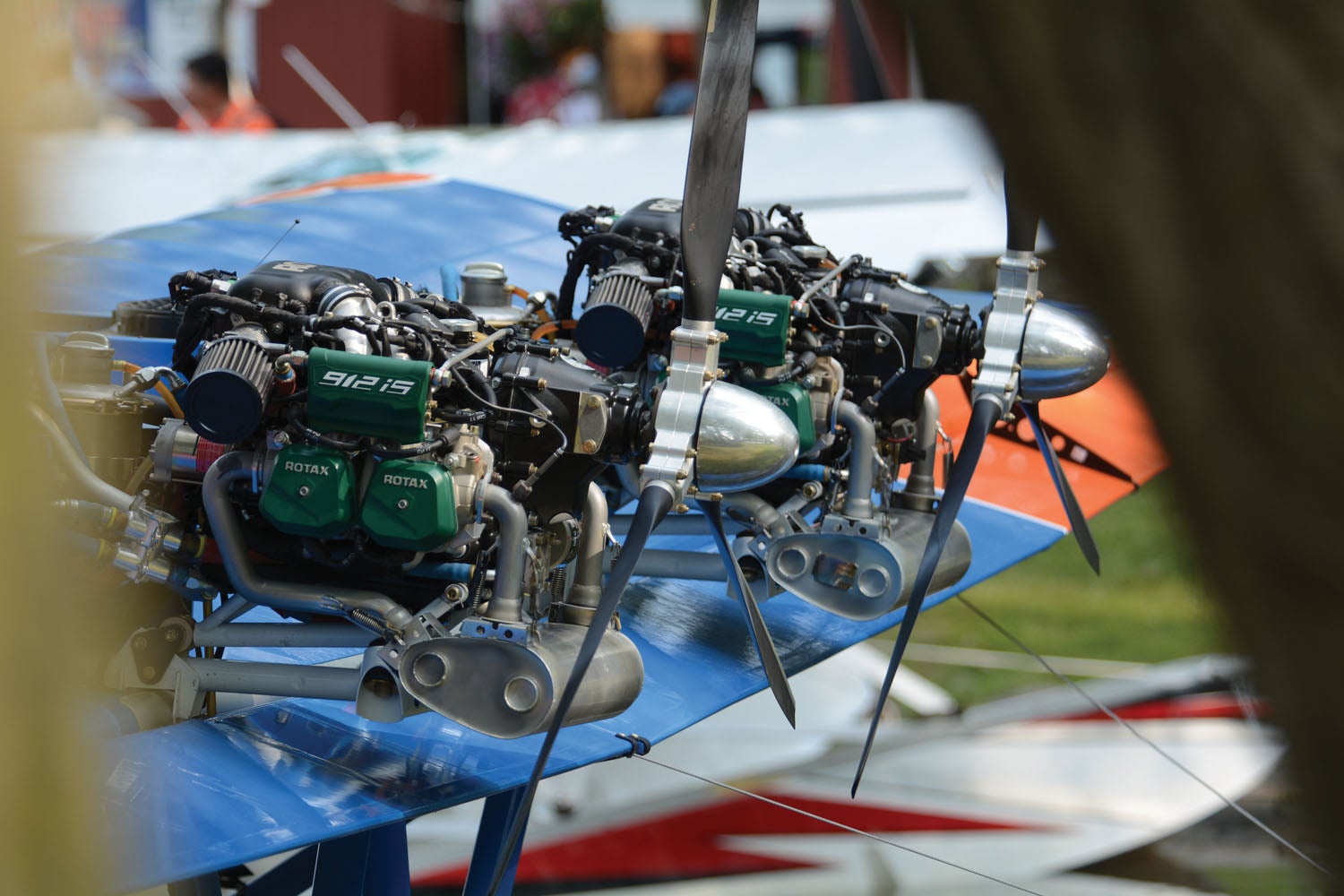

For all-around performance and utility, it’s tough to beat the 912 series of Rotax engines. Customers are more willing to pay for the electronically fuel injected models lately say Rotax dealers.
Old hands think of Continental or‭ ‬Lycoming as the world’s number one‭ ‬light aircraft engine makers‭, ‬but by a large margin it’s actually been Rotax for a long while‭. ‬A division of BRP‭, ‬Rotax is based in central Austria‭, ‬where it is tasked with‭ ‬building engines for the greater BRP‭ ‬empire which includes all sorts of light recreational vehicles such as side-by-side utilities‭, ‬boats‭, ‬personal watercraft‭, ‬snowmobiles‭, ‬motorcycles‭, ‬and light aircraft‭. ‬Therefore‭, ‬Rotax is a larger engine maker than it might seem at first‭, ‬with first-rate production facilities and engineering‭. ‬
For 2020‭ ‬Rotax is continuing with its existing 912‭, ‬914‭ ‬and 915‭ ‬series engines‭ ‬which combine air-cooled cylinders‭ ‬with water-cooled cylinder heads‭. ‬These‭ ‬relatively lightweight and compact‭ ‬engines are designed for higher rpm‭, ‬therefore they all include a built-in spur‭ ‬gear propeller speed reduction unit‭ ‬‭(‬gearbox‭) ‬to optimize propeller rpm‭. ‬All are dry sumped and employ hydraulic valve lifters‭; ‬carburetor or electronic‭ ‬fuel injection are offered depending‭ ‬on the model‭. ‬Warranty periods are‭ ‬relatively short for Rotax engines in‭ ‬experimental applications‮—‬just 18‭ ‬months or 200‭ ‬hours‮—‬but in certified aircraft that grows to two years or 400‭ ‬hours for essentially the same hardware‭. ‬Also lengthening over the years has‭ ‬been Time Between Overhauls for the four-stroke Rotaxes‭; ‬the 912‭ ‬is now at 2000‭ ‬hours TBO‭. ‬Rotax offers several distributors and‭ ‬maintenance facilities in North America‭, ‬with some of those‭, ‬such as California Power Systems and‭ ‬Lockwood Aviation‭, ‬offering various schools for interested homebuilders‭ ‬or maintenance pros‭. ‬The engines are dependable and rebuildable‭. ‬
Still the best selling Rotax is the‭ ‬carbureted 912‭ ‬series‭, ‬available in 80‭ ‬hp‭ ‬carbureted form as the 912‭ ‬UL or with 100‭ ‬hp as the 912‭ ‬ULS‭. ‬The 80‭ ‬hp is most popular in Europe where higher octane gasoline is difficult to find while the 100‭ ‬hp variant is number one in‭ ‬the United States‭. ‬It’s worth noting‭, ‬however‭, ‬that Rotax engines do best on unleaded‭ ‬mogas because the lead in 100LL eventually accumulates as sludge‭ ‬in the gearbox‭. ‬Furthermore‭, ‬Rotax‭ ‬says the‭ ‬912’s market share is starting to transfer quickly to the 912‭ ‬IS and turbocharged 915‭ ‬IS engines‭, ‬both of which feature electronic fuel injection‭. ‬
Rotax offers two turbocharged engines‭, ‬the carbureted 914‭ ‬and its newest‭ ‬powerplant‭, ‬the 915‭ ‬IS‭, ‬which is entering its second year of full production‭. ‬The latter is definitely spendy at over‭ $‬38,000‭, ‬but offers the best power-to-weight ratio in its class‭, ‬along with a meaty 141‭ ‬hp up to 15,000‭ ‬feet for excellent mid-altitude performance‭. ‬By comparison‭, ‬the 914‭ ‬will save you about‭ $‬7,000‭ ‬in trade for carburetion and a maximum of 115‭ ‬hp‭; ‬the 914‭ ‬has a TBO‭ ‬of 2000‭ ‬hours compared to the 915’s 1200‭ ‬hours‭, ‬as well‭.‬
If the all-singing‭, ‬all-dancing 915‭ ‬Rotax‭ ‬does offer some interesting performance capabilities to anyone interested in zipping along just a bit shy of the flight‭ ‬levels‭, ‬it’s worth remembering even the‭ ‬entry-level 80-hp Rotax offers aviating‭ ‬for notably less than half the money and in a definitely less-stressed‭, ‬should-last‭-‬forever package‭. ‬

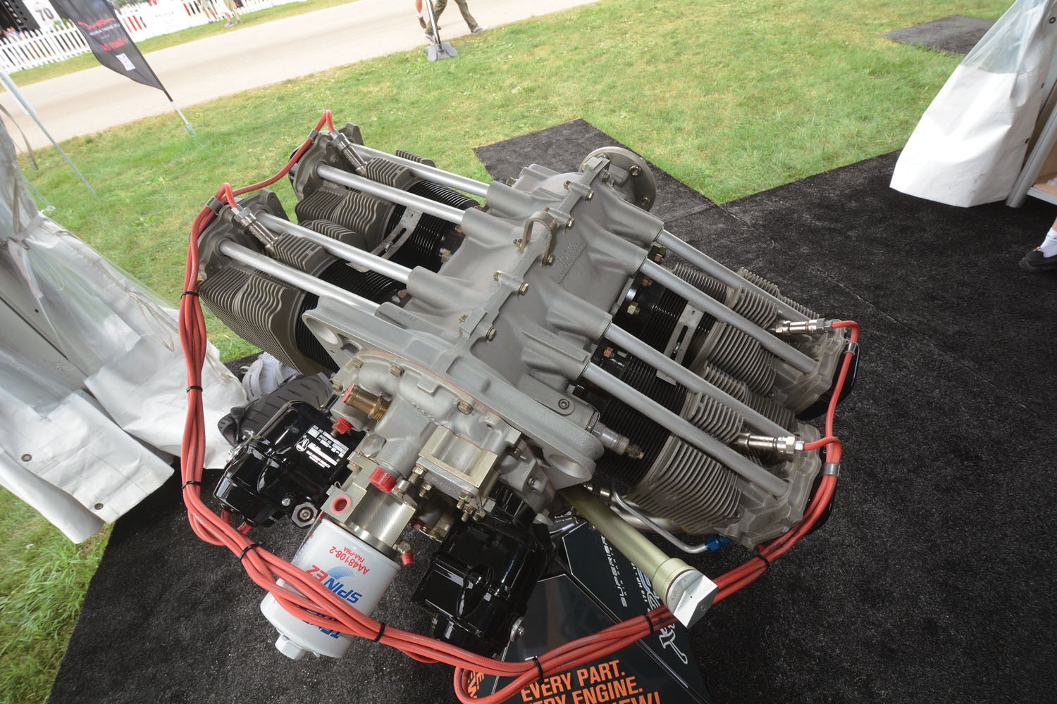

Continental‭ / ‬Titan
5 Continental IO550
Big-bore Continentals such as this IO-550 are popular performance engines in fast-plastic airplanes, but not available to experimental builders factory-direct. Best to source these via a performance engine shop.
Last year we reported The Big C had started construction of a new headquarters‭ ‬and manufacturing facility‭ ‬in Alabama‭, ‬very close to its heritage site in Mobile‭. ‬We can now report all‭ ‬administrative and engineering staff‭ ‬have moved into the new building‭, ‬but at our press time manufacturing was continuing in the old factory as the new machine tools‭ ‬were arriving and being‭ ‬installed‭. ‬It’s proving to be a large‭, ‬lengthy process‭, ‬but generally speaking the new manufacturing line should be operational in late 2020‭. ‬
The new plant should also be worth the wait as not only is the building new‭, ‬but the manufacturing machinery inside will also jump forward a generation or‭ ‬more‭. ‬A good example is crankshaft‭ ‬manufacturing‭. ‬Currently it takes eight machines plus heat treating to bring a crankshaft to life‭; ‬that will change to‭ ‬one machine in the new plant‭. ‬That‭ ‬means seven fewer set-ups to save both costs and increase machining accuracy‭. ‬
Continental continues to offer a huge selection of engines if you consider the various legacy certified gasoline Continentals‭, ‬the newer certified diesel‭ ‬engines‭, ‬plus its Titan line of experimental derivatives of Lycoming parallel-valve architecture engines‭ (‬320‭, ‬340‭, ‬370‭ ‬four-cylinders and a 540‭ ‬six-cylinder‭). ‬They now even have a certified version of the 370‭ ‬parallel-valve engine‭, ‬sort of like Ford building its version of a Chevy LS‭.‬
Now‭, ‬before getting carried away‭ ‬on Continental‮—‬we should say Titan‭, ‬because that is the brand they are being sold under‮—‬building Lycoming clones‭, ‬Continental/Titan is quick to point‭ ‬out its improvements of the breed‭. ‬For‭ ‬sumps/intake manifolds Titan’s standard offering is a magnesium version of‭ ‬the traditional‭ ‬“hot sump”‭ ‬casting‭; ‬it‭ ‬saves a meaningful seven pounds over the original aluminum casting‭. ‬Optional sumps are either Titan’s vertical or the Superior Air Parts cold air intake with a forward-facing throttle body inlet‭. ‬There is no forward facing hot sump‭, ‬or rear-facing sump of any kind‭. ‬
Titan engines also boast steel insert thrust washers for the crankshaft‭. ‬The original design has thrust loads taken by the parent aluminum of the case‭, ‬which can gall if run hard before fully wetted during break-in or under very‭ ‬hard loads or extreme time in service‭. ‬Titan simply machines its cases to accept the steel thrust washers first seen in Continental 470/520‭ ‬engines to essentially eliminate this issue‭. ‬
All Titan engines now fit roller valve lifters as standard‭, ‬although if you really‭ ‬want flat tappets they are optional‭. ‬Titans allow front or rear propeller‭ ‬governors as the customer specifies‭, ‬too‭. ‬Also stock is Continental’s nickel-carbide cylinder treatment‭ (‬NiC3‭) ‬for better durability and corrosion resistance‭. ‬They’re happy enough with it to offer a five-year warranty against cylinder rusting on all Titan engines along‭ ‬with its normal two-year or TBO warranty on the rest of the engine assembly‭. ‬Warranties begin when the engine is put in service‭, ‬not to exceed one year after purchase‭. ‬
Another help is now that the 370‭ ‬engine has been certified under‭ ‬the Continental Prime banner‭, ‬the required Operator’s plus the Maintenance and Overhaul manuals are‭ ‬now available‭; ‬they should be a help to all Titan engine owners‭. ‬And for RV builders‭, ‬Titan is offering the base version of several of its engines‮—‬these are engines configured for specific RV models‮—‬at‭ ‬“very competitive”‭ ‬prices on the Titan website‭. ‬This gives simple‭, ‬check-the-box shopping for RV engines‭, ‬albeit just in the configuration suggested by Van’s‭. ‬If modifications from those standards are desired‭, ‬it’s back to the regular Titan line-up‭. ‬
Speaking of modifications‭, ‬while‭ ‬Titan does not offer a‭ ‬“custom shop”‭ ‬storefront‭, ‬Titan offers an extensive‭ ‬line of optional gear buyer’s can choose from‭. ‬The aforementioned Superior cold air intake is one example‭, ‬another is the newest EFII System 32‭ ‬electronic engine management system‭, ‬added in the fall of 2019‭. ‬All Titans have electronic ignition of some sort‭. ‬
As for 540s‭, ‬Titan is the only source‭ ‬other than Lycoming for these powerful‭, ‬lightweight six-cylinders‭. ‬Titan has‭ ‬one helicopter customer taking a slow‭, ‬steady supply of these‭, ‬along with the occasional RV-10‭ ‬builder‭. ‬

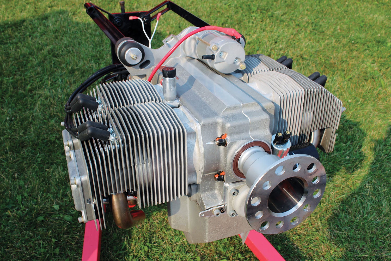

Extreme compactness and light weight are what D-Motor gained by reverting to a flathead valvetrain. North American-bound D-Motor engines are to be assembled in Canada soon.
Another engine from Belgium is the technically curious D-Motor‭. ‬We say‭ ‬curious because it combines the very dated flathead combustion chamber layout‮—‬shades of your‭ ‬’32‭ ‬Highboy‮—‬with such advanced features as dual electronic engine management‭. ‬Actually‭, ‬the flat-head design is not quite as technologically antiquated as it might seem‭. ‬With‭ ‬rpm limited to just 3000‭ ‬revolutions‭, ‬engine breathing is less demanding than in higher speed engines‭, ‬so the flathead‭ ‬layout‮—‬where the valves are sequestered in the engine block‭ (‬case‭)‬‮—‬doesn’t pose as much breathing restriction as we might first think‭. ‬Let’s also note the flathead combustion chamber is hardly the last word in efficiency and certainly would never pass emissions testing as an automotive engine‭, ‬but for the moderate compression ratios run in aircraft engines and without emission limits to contend with the D-Motor proves its contrarian point‭. ‬
The flathead advantages are a very‭ ‬much more compact engine‭, ‬especially‭ ‬in width‭, ‬along with a lesser parts‭ ‬count‭, ‬reduced weight and cost‭. ‬It’s‭ ‬simple‭, ‬in other words‭, ‬and that’s rarely‭ ‬a bad thing in aircraft where simple‭ ‬typically means reliable‭. ‬
More to the high-tech side‭, ‬D-Motor used Nikisil coated cylinders for corrosion resistance‭. ‬This is a high-nickel‭ ‬treatment favored by Porsche‭, ‬among‭ ‬others‭. ‬There are the dual computers‭, ‬electronic fuel injection and ignition‭, ‬and it’s worth noting the fuel injection is returnless‭, ‬meaning there is no need to plumb a fuel line from the engine back to the fuel‭ ‬tank‭. ‬Also convenient are the engine mounting points‭; ‬they are identical to Jabiru and ULPower engines‭, ‬which aids finding a workable mount‭. ‬
Given its bent for simplicity‭, ‬the‭ ‬D-Motor is understandably not a real‭ ‬fire-breather‭. ‬The four-cylinder version‭ ‬is rated at 92‭ ‬hp‭; ‬the six-cylinder variant yields 125‭ ‬hp/121‭ ‬hp continuous‭, ‬also‭ ‬at 3000‭ ‬rpm for maximum power‭, ‬so‭ ‬smaller diameter propellers are a must on these direct-drive engines‭. ‬But for an LSA where reduced weight and simplicity are key‭, ‬the D-Motor seems better suited‭. ‬
Let’s also note that after a rocky start several years ago‭, ‬D-Motor has replaced its original North American distributor‭. ‬Furthermore‭, ‬North America has been overshadowed by European demand for D-Motors‭, ‬but recognizing the market here D-Motor is setting up an‭ ‬assembly facility in Canada to service the Americas‭. ‬It will assemble engines using parts‭ ‬manufactured in Belgium‭. ‬A deposit‭ ‬system‭ ($‬1000‭ ‬into an escrow account‭) ‬is now in place‭; ‬expect Canadian engine‭ ‬assembly for North America and thus‭ ‬engine deliveries here to commence in early‭- ‬to mid-2020‭. ‬

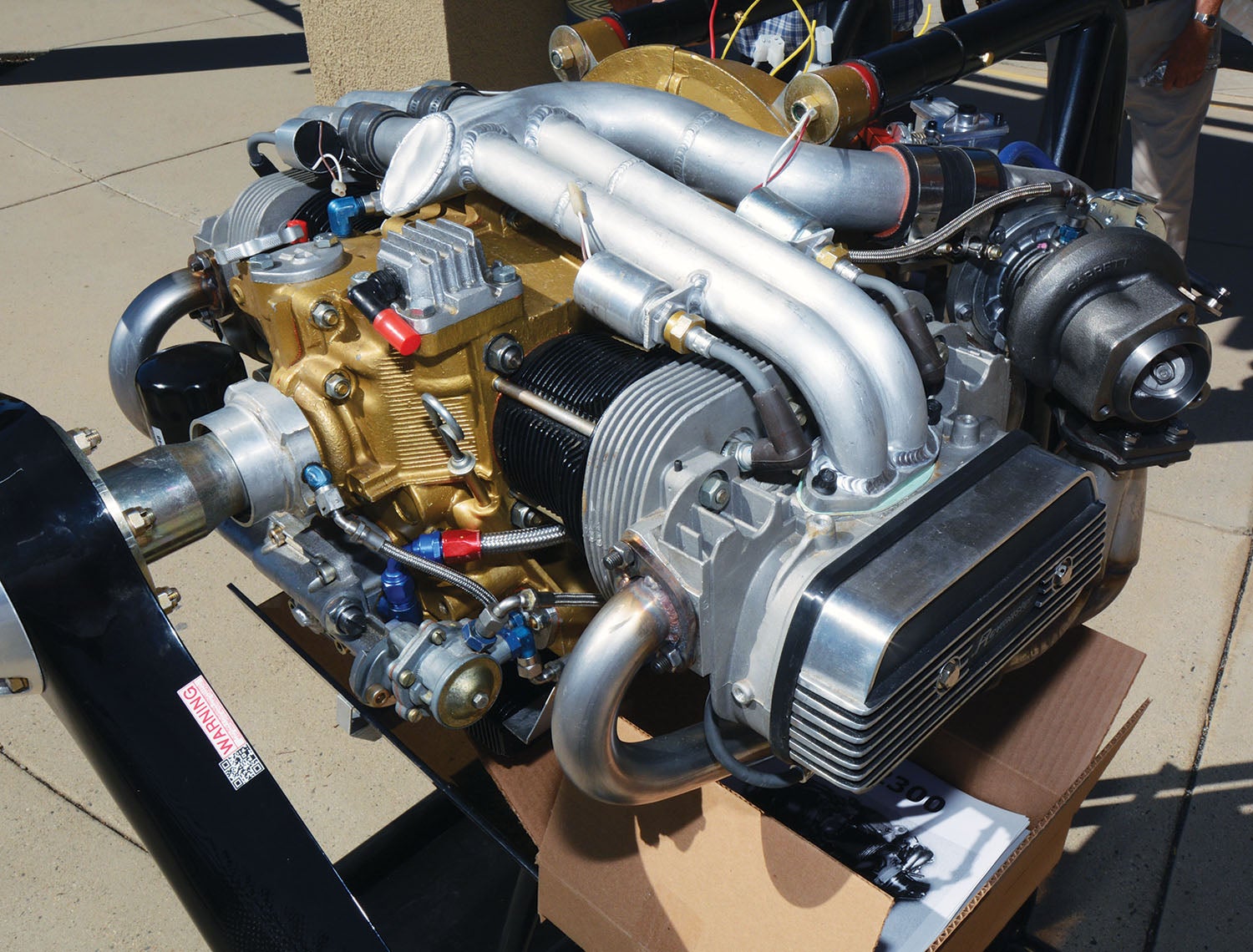

Jabiru
7 Jabiru
Jabiru’s fourth-generation engines can be identified by the head and cylinder cooling fins that are relatively even in height. Earlier Jabirus featured cylinder head fins notably taller than the cylinder fins.
Seemingly having found its stretch in its fourth generation‭, ‬the Australian Jabiru‭ ‬engines make a simple-is-better appeal‭ ‬to LSA and smaller E/A-B aircraft‭. ‬Their combination of lower cost and simplicity‭ ‬via air cooling‭, ‬direct-drive and simple‭ ‬slide-carburetion have made them popular at the populist end of the light aviation market‭, ‬including the Arion Lightning‭, ‬which‭ ‬is appropriate as Arion is the Jabiru distributor for North America‭. ‬
The fourth generation Jabiru relies heavily on aluminum construction of‭ ‬the crankcase and cylinders‮—‬silicon carbide and nickel coated‮—‬for low‭ ‬weight and rapid heat transfer‭. ‬Jabiru in Australia has the parts mainly constructed by specialist machine shops‭ ‬in South Queensland‭, ‬Australia‭, ‬then assembles them in its own nearby facility before shipping them to Arion in‭ ‬
Shelbyville‭, ‬Tennessee‭. ‬Although sales are good and the supply chain between Australia and the U.S‭. ‬is always moving‭, ‬so it’s smart to plan ahead when ordering‭, ‬which is done through Arion‭. ‬
Two engines are offered‭, ‬a four‭-‬cylinder 2200‭ ‬rated at 80‭ ‬hp and a‭ ‬six-cylinder 3300‭ ‬good for 120‭ ‬hp‭. ‬Both are popular‭, ‬the just 132-pound 2200‭ ‬in the smaller Zenith and Sonex airframes‭; ‬the bigger 3300‭ ‬typically being seen in the‭ ‬Arion‭, ‬larger Zenith‭, ‬RANS and Van’s models‭. ‬Again‭, ‬simplicity‭, ‬light weight and affordable‭ ‬cost are Jabiru goals‭, ‬so both engines use a single Bing slide-type carburetor‭, ‬mechanical fuel pump‭, ‬and inductive ignitions built into the flywheel‭. ‬There are distributors‭, ‬but they have no timing component‭ ‬as timing is fixed‭. ‬Both the alternator and ignition are integral to the engine‭, ‬and both should be working as long as the engine is rotating‭. ‬
Perhaps unique in general aviation‭, ‬Jabirus are fitted with RAMAIR air‭ ‬ducts at the factory‭. ‬These fit under the cowling and simplify engine installation as the air baffling is already fitted to the‭ ‬engine‭. ‬There are no technical or price changes to the Jabiru line for 2020‭. ‬

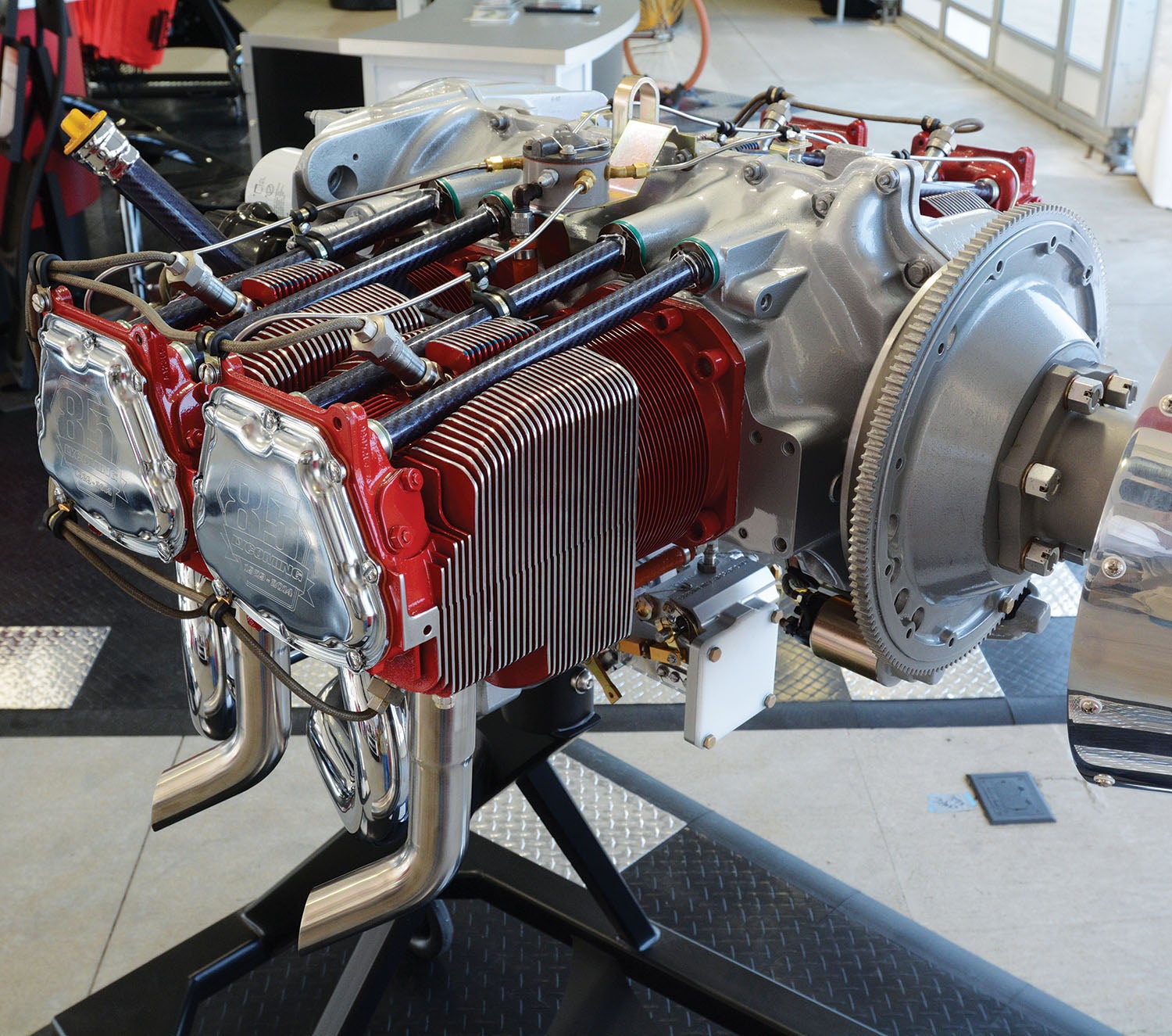

Lycoming
8 LycomingT BoltRed
Lycoming’s Thunderbolt line continues to grow in popularity. Performance mods are a given, as are dress-up items. Besides the red paint, this one sports carbon weave pushrod tubes and oil filler, along with some chrome bling.
In the traditional big-bore‭, ‬direct-drive aviation piston world‭, ‬Lycoming continues it dominance of the Experimental/Amateur-Built market‭. ‬Embracing‭ ‬the experimental airframers years ago‭ ‬has been a big part of why its engines‮—‬or clones thereof‮—‬are seen more often‭ ‬than any other in the burgeoning‭ ‬build-it-yourself airplane neighborhood‭. ‬Also‭, ‬with Continental now‭ ‬owned by the Chinese‭, ‬Lycoming is the last large U.S‭.-‬owned aircraft engine manufacturer and thus has a leg-up in the drone/UAV‭ ‬market where military‭ ‬contracts lean toward U.S‭. ‬content‭. ‬Today Lycoming continues to extend‭ ‬its reach by offering anything from dead stock grocery-getting certified‭ ‬mills to extreme performance thumpers for aerobatic and racing fans‭. ‬
For 2020‭ ‬Lycoming reports more of the same in the engine hardware department‭, ‬with no price increase‭, ‬but there is an increasing‭ ‬range of optional gear on its hot rod engines‭. ‬The latter includes a new electronic ignition system developed as a Lycoming part in partnership‭ ‬with SureFly‭. ‬A drop-in replacement‭, ‬magneto-like‭, ‬electrically self-generating unit‭, ‬its big potential is adjustable ignition timing for better fuel economy‭, ‬along with no maintenance or overhaul requirement for the life of the engine‭. ‬Experimentals can run the system now‭; ‬CubCrafters‭ ‬is one of the first of the certifieds to offer it stock‭. ‬
Before talking options on the Thunderbolt engines‭, ‬we should note a balanced crankshaft and reciprocating assembly is standard‭, ‬as are ported‭ ‬cylinders and limited number of paint colors‭ (‬more colors are optional‭, ‬as is‭ ‬chrome detailing‭). ‬Airflow Performance‭ ‬or Avstar constant-flow‭, ‬mechanical‭ ‬fuel injection is also standard‭, ‬along‭ ‬with magneto ignition‭. ‬Not to be overlooked‭, ‬all Thunderbolt engines are broken in on one of Lycoming’s dynos for between 1.5‭ ‬and 3‭ ‬hours‭, ‬eliminating any worries about the engine’s viability during the first flight‭, ‬plus relieving the harried‮—‬and often‭ ‬apprehensive‮—‬pilot from following‭ ‬restrictive engine break-in protocols‭.‬
Typical modifications in the Thunderbolt line are increased compression to 10:1‭, ‬with the caveat that 100LL fuel is then required‭ (‬no mogas‭), ‬along with‭ ‬any number of electronic ignitions‭. ‬P-MAG and LightSpeed Engineering‭ ‬Plasma series are popular‭. ‬
It’s a measure of how custom-oriented the engine market is getting to hear‭ ‬Lycoming say its Thunderbolt engines‭ ‬are best-sellers and constitute approximately 35‭ ‬percent of its production‭. ‬The biggest issue they’ve reported recently‭ ‬is keeping up with demand‭. ‬All Thunderbolts are assembled in the Advanced Technology Center‭, ‬a dedicated shop inside Lycoming’s Williamsport‭, ‬Pennsylvania facility where two-man teams concentrate on building one engine at a time‭. ‬Lycoming says they have‭ ‬three such build teams working and need to add more‭, ‬always a good sign‭. ‬
And where are all the engines going‭? ‬On Van’s RVs‭, ‬of course‭, ‬followed by‭ ‬the back country airplanes according‭ ‬to Lycoming‭. ‬The remainder of Thunderbolt and mainstream Lycoming production is spread over the entire range‭ ‬of experimental and general aviation‭, ‬including some direct sales overseas‭. ‬
As for the engines themselves‭, ‬Lycoming lists its familiar‭, ‬O-235‭, ‬320‭, ‬360‭, ‬390‭, ‬540‭ ‬and 580‭ ‬cubic inch‭ ‬designs in its Thunderbolt line-up‭. ‬That’s pretty much the entire line of current Lycoming production save the eight-cylinder 720‭, ‬which can still be had as a certified‭ ‬engine if you really need that much oomph‭. ‬Of the engines offered‭, ‬all use parallel valve cylinders except the 390‭ ‬and 580‭, ‬which employ angle-valve cylinder heads‭. ‬That makes them more efficient and powerful‭, ‬but also heavier‭. ‬
Finally‭, ‬to put things in perspective‭, ‬Lycoming holds one major trump card in the time-tested nature of its‭ ‬powerplants‭. ‬There are so many Lycs‭ ‬flying that the company estimates the Lycoming brand accrues 1‭ ‬million fleet hours monthly‭. ‬

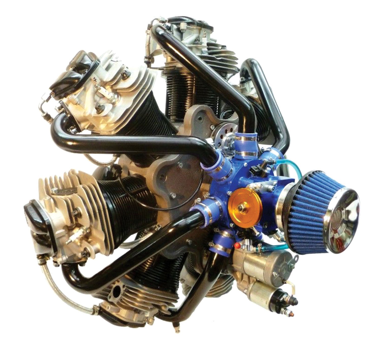

Pegasus
9 Pegasus
Pegasus’ half-an-O-200 is taking a little longer than hoped to reach production, but 2020 really should be the year this new engine comes to market.
Patience is a virtue around new engines‭; ‬witness the O-100‭ ‬Pegasus DP-1‭, ‬a twin-cylinder derivative of the mega-popular O-200‭ ‬Continental‭. ‬It’s designed to use all-new Pegasus parts where needed and existing Continental O-200‭ ‬parts as possible‭. ‬LSA fans have been patiently waiting for the engine for several years since the first-article DP-1‭ ‬was first shown running on an engine stand‭, ‬and while‭ ‬this should have been the year the new 58-hp engine went into production‭, ‬we’re going to need a little more patience says Pegasus majordomo Pete Plumb‭.‬
Two changes have slowed the DP-1’s debut‭. ‬To provide slimmer packaging‭, ‬Plumb has spent the last two years redesigning the oil sump and case to accommodate the intake runners‭. ‬Not only does this allow tucking the intake runners more tightly under the engine‭, ‬but allows mounting the carburetor‭ ‬directly to the aft end of the plenum at the back of accessory case‭, ‬either horizontally or vertically‭. ‬To save weight‭ ‬Plumb favors simple slide-type carburetors‭. ‬Achieving the new carburetor mounting meant extending the engine case a half inch deeper than a stock O-200‭. ‬Therefore a stock Continental accessory case would still work‮—‬if a moon-shaped shim was inserted in the‭ ‬gap‮—‬but Plumb wanted the better‭ ‬solution of modifying the case to fit‭. ‬
The other change was from the originally intended Austempered Ductile‭ ‬Iron‭ (‬ADI‭) ‬crankshaft to a traditional forging‭. ‬The ADI process has strength-to-weight and prototyping advantages‭, ‬but apparently all such manufacturing‭ ‬capability has been outsourced from‭ ‬Detroit to Mexico‭, ‬complicating things impossibly for the DP-1’s small production runs‭. ‬Plumb has therefore reverted to the tried-and-true forging process‭, ‬and was awaiting proof samples at our deadline‭. ‬Once the forged crankshaft is proven via testing by Pegasus the remainder of the engine has been finalized and is production-ready‭; ‬a prototype DP-1‭ ‬has already completed 50‭ ‬hours of trouble-free flight testing‭. ‬
Furthermore‭, ‬along with the costly‭ ‬investment in forging dies‭, ‬Pegasus is ready‭ ‬with relatively high volume parts runs‭ ‬by aviation standards‮—‬100‭ ‬engines‮—‬to hopefully satisfy start-up demand‭. ‬Plumb also pointed out there is no price increase due to‭ ‬the crankshaft change‭. ‬

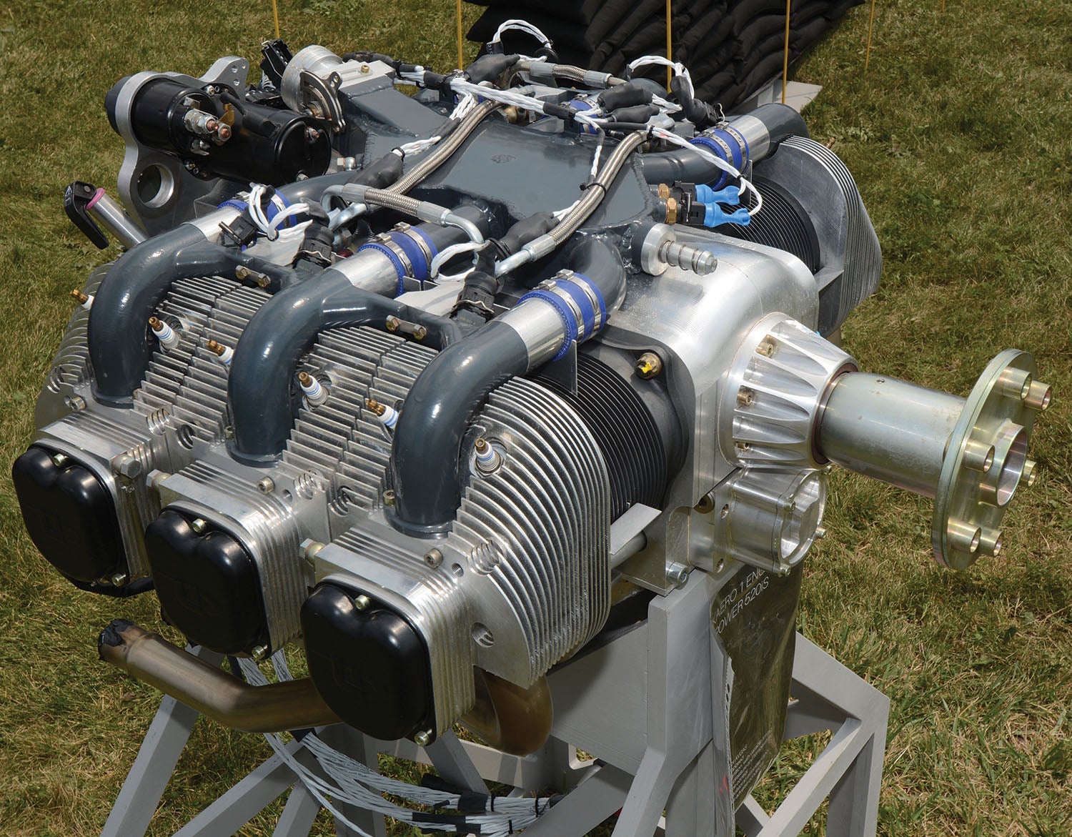

Parts maker turned engine manufacturer Superior has a huge line of upgraded Lycoming-architecture parts to draw on. Their cold air intake/sump is the industry standard for experimental Lycomings and their derivatives.
Superior Air Parts comes to engine‭ ‬building from decades of building‭ ‬aftermarket replacement parts for‭ ‬popular engines‭, ‬especially Lycomings‭. ‬As its inventory of part numbers grew‭, ‬it became logical for them to begin selling‭ ‬complete engine kits‭, ‬and eventually‭ ‬assembling its parts into replacement‭ ‬engines‭. ‬Superior is quick to point‭ ‬out‭ ‬that they’ve upgraded materials and‭ ‬manufacturing processes to provide‭ ‬better parts at competitive prices‭. ‬They’ve also provided important competition to help keep costs in line across the engine marketplace‭. ‬
While Superior offers some certified engines‭, ‬it is its XP line of experimental‭ ‬engines based on Lycoming architecture that are of interest to experimental‭ ‬builders‭. ‬Several options are available‭, ‬including your choice of flat or roller tappets‭, ‬or intake manifolds based on the original Lycoming model of combined oil sump/intake manifold or‭ ‬Superior’s cold air style intake‭. ‬
The Superior cold air intake is its more popular offering‭, ‬not only due to the efficiency of the cold air design‭, ‬but also because it is available in traditional updraft or horizontal layouts‭. ‬The horizontal cold air allows a slimmer cowling and eases packaging a ram style air inlet‭, ‬while the updraft version accommodates existing standard-depth cowls‭. ‬Superior offers a choice of Bendix-style mechanical fuel injection from Precision Airflow or traditional carburetion on all its engines‭.‬
Superior was offering 382‭ ‬and 400‭ ‬cubic inch stroker versions‭ (‬longer‭ ‬crankshaft throw‭) ‬of its engine‭, ‬but‭ ‬after some issues Superior recalled those engines in a buy-back program and is no longer offering strokers‭. ‬
Another initiative of Superior’s is the Gemini opposed-piston Jet A fuel engine‭. ‬While the project was announced several years ago‭, ‬it is still in development‭ ‬and is not for sale at this time‭. ‬Superior is based‭ ‬in Texas and is Chinese-owned‭. ‬

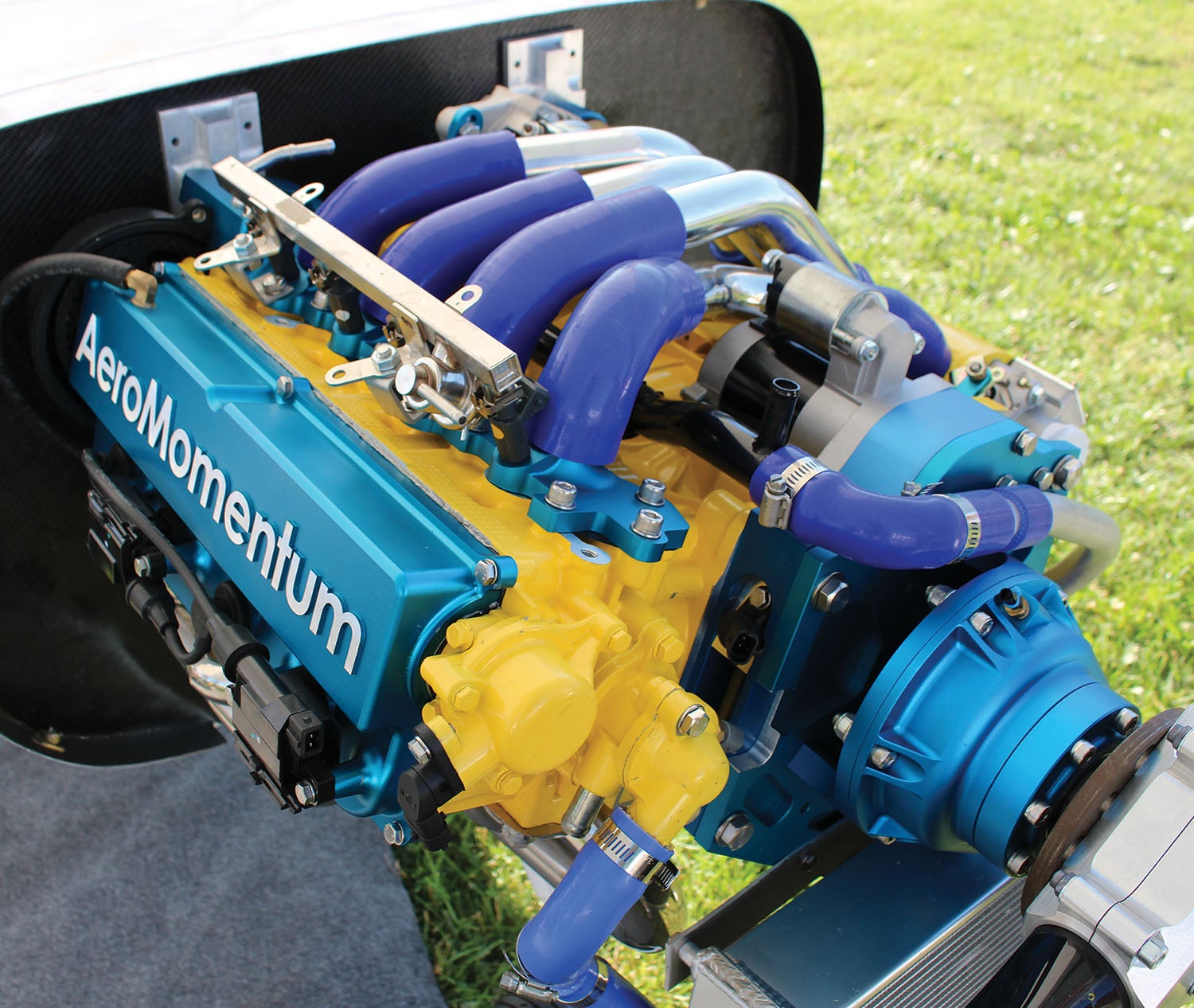

12 AeroMomentumAM15h
AeroMomentum’s line of auto conversion engines is well-supported by in-house electronic expertise. This includes a new-this-year Aero-Graph instrument that allows the pilot to closely monitor ECU performance using one or more displays.
It’s not everyday an engine maker says its biggest challenge is finding enough of the right employees to keep up with demand‭, ‬but that’s the current challenge at the compact‭, ‬privately-owned Aero-Momentum where work mainly consists of converting various non-V-8‭ ‬automotive engines into aero powerplants‭. ‬
For 2020‭, ‬the AeroMomentum eight‭-‬strong engine line-up is unchanged‭, ‬meaning a 1000cc three-cylinder‭, ‬1300‭ ‬and 1500‭ ‬four-cylinders and a turbocharged 2.0-liter four-cylinder‭. ‬Power ranges from 75‭ ‬to 260‭ ‬hp via a series of standard and high-performance variants of most of these different displacements‭. ‬Suzuki is the source of the 1300‭ ‬and 1500‭ ‬engines‭; ‬the others are non-Suzuki and cannot be revealed as part of the sourcing agreement‭. ‬All engines are‭ ‬built from all-new parts‭; ‬no salvage or used engines are ever used‭.‬
What is new is the‭ $‬585‭ ‬Aero-Graph‭, ‬an engine monitor AeroMomentum‭ ‬builds in-house‭. ‬A plug-and-and-play‭ ‬unit‭, ‬the Aero-Graph displays what’s‭ ‬going on inside the AeroMomentum‭ ‬FADEC computer‭, ‬plus oil pressure‭, ‬temperature and fuel pressure‭. ‬Because it is CAN bus compatible‭, ‬multiple Aero-Graphs can be daisy chained together or used with‭ ‬an EFIS‭ (‬AeroMomentum offers one of those‭, ‬too‭) ‬in any combination‭. ‬Aero-Graph is sold with the round display that fits into a‭ ‬2-inch panel cutout‭, ‬harness and the three oil and fuel sending units‭. ‬It offers a series of pre-set out-of-limit alarms‭ (‬programmable via cell phone if desired‭) ‬and is calibrated to the supplied sensors‭. ‬
A more minor change is AeroMomentum is now CNC-porting rather than hand-porting its cylinder heads‭. ‬
Core to AeroMomentum’s conversions is a helical‭, ‬spur-gear prop reduction gearbox‭. ‬It features custom 8620‭ ‬alloy gears‭ (‬these aren’t quick change‭ ‬auto racing gears‭), ‬and like many of‭ ‬AeroMomentum’s other parts‭, ‬is‭ ‬designed in-house‭; ‬forged‭, ‬machined‭, ‬heat-treat and otherwise produced by out-of-house vendors‭; ‬then assembled in-house at AeroMomentum‭. ‬The highest time gearbox so far logged 5500‭ ‬hours in an airboat with no issues‭. ‬

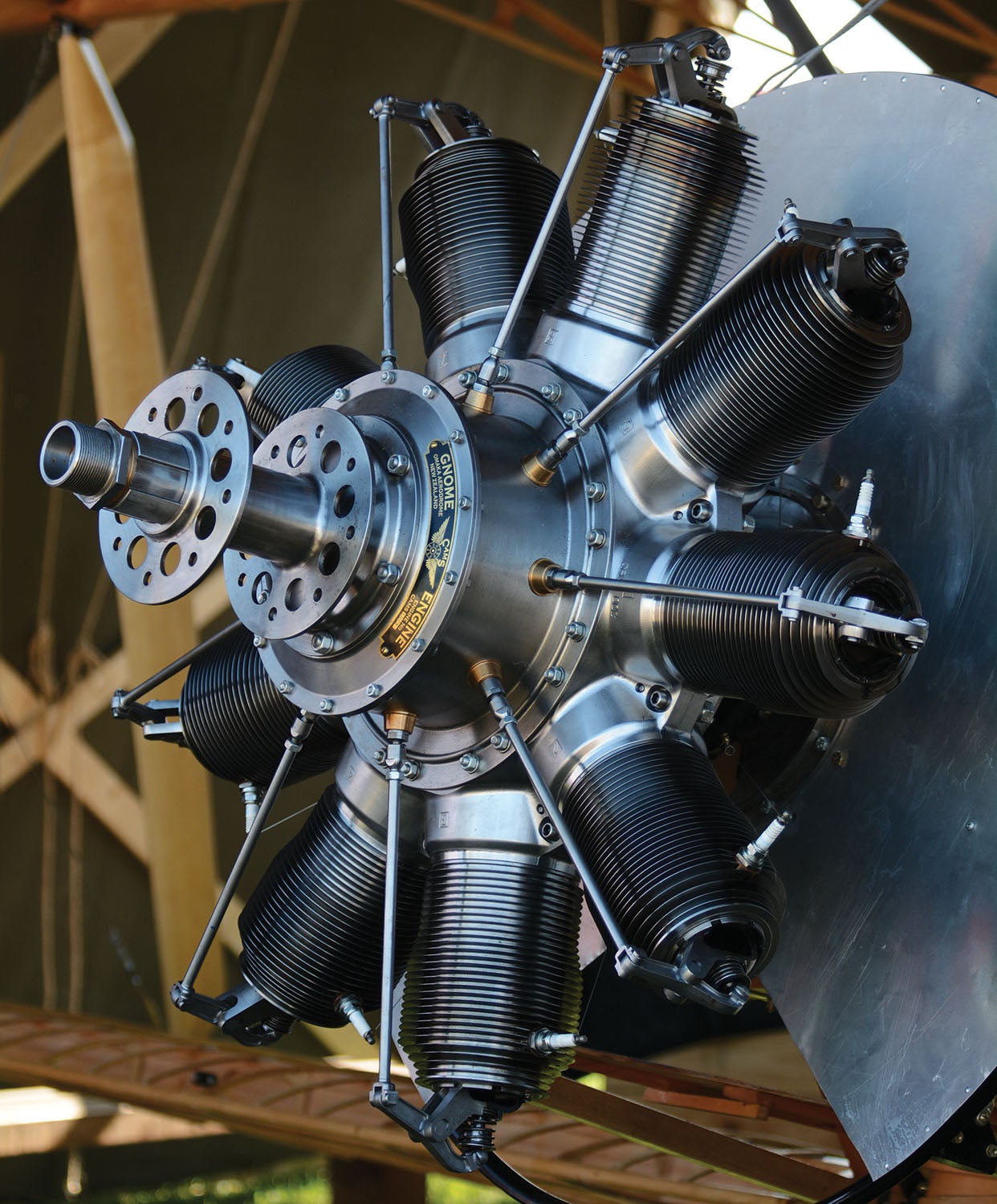

Whether you’re in the market for an honest-to-gosh rotary engine or not, you have to admit Classic Aero Machining’s take on the venerable Gnome Monosoupape is a thing of beauty.
With its barking exhaust‭, ‬intermittent‭ ‬cylinder cut-out‭ ‬“idle”‭ ‬and memorable‭ ‬gyroscopic personality‭, ‬there’s nothing in aviation that begins to replicate the experience brought by a rotary engine‭. ‬And for those seeking the ultimate authentic WW-I experience‭, ‬New Zealand based Classic Aero Machining has been developing a brand new Gnome monosoupape engine for several of years‭. ‬It is a faithful rendition of the Gnome used in many French‭, ‬English and German aircraft just‭ ‬prior to and during the first war‭. ‬
This year CAM has improved the‭ ‬induction ports and developed a fuel pump for the engine‭ (‬the originals relied strictly on gravity‭). ‬Purists may decry it‭, ‬but CAM also has an electric starter for its rotary‮—‬it must be the first non hand-propped rotary ever‮—‬and lists output at a muscular‭ ‬120‭ ‬hp and 580‭ ‬pound-feet of torque while whirling at just 1120‭ ‬rpm‭. ‬
CAM wants to emphasize these‭ ‬engines are viable‭, ‬reliable‭, ‬real-world‭ ‬choices for WW-I replicas and that they’re in rotary business for the long term‭. ‬They certainly are the only new engine capable of delivering the true‭ ‬early-bird rotary experience‭, ‬which‭ ‬might be a little more performance oriented‭ ‬than first imagined‭. ‬CAM reports its‭ ‬rotary has a Sopwith Pup replica going 110‭ ‬mph straight and level‭, ‬plus 1000‭ ‬fpm vertically‭. ‬They expect several more of its engines to fly by next spring‭.‬
CAM is part of the burgeoning replica and restoration scene in New Zealand and has a well-established business replicating various warbird parts‭, ‬especially P-40‭ ‬items‭. ‬

Interest is definitely building in the Verner line of radials, which range from a rather compact three-cylinder to a 158-hp nine-cylinder. In fact, the Verner line was so populous they cut back to one each of their larger five-, seven- and nine-cylinder Scarlett models this year.
A bit under our lower power limit is the little 42-hp three-cylinder engines put out by Verner Motor‭, ‬but if you have‭ ‬raging dreams of a Demoiselle reproduction‭, ‬the pocket-sized Verner radial bears a look‭. ‬Otherwise‭, ‬one of Verner’s larger five‭, ‬seven‭, ‬or nine-cylinder radials has the compact dimensions to fit a number of fun-flying personal planes and give‭ ‬them the unmistakable round motor look‭, ‬feel and sound‭. ‬So far that’s been Hatz biplanes‭, ‬older Kitfoxes and a slew of WW-I replicas‭, ‬both scale and full-size‭, ‬as Verner continues to make in-roads‭ ‬on the U.S‭. ‬market‭. ‬
Built in the Czech Republic by a‭ ‬small company that’s been in the airplane engine business since 1993‭, ‬the Verner radials we’re detailing here use the same two-valve‭, ‬3.62‭ ‬x 4.02-inch cylinder‭, ‬but fit five‭, ‬seven‭, ‬or nine of them as power needs rise‭. (‬Let’s note‭ ‬the little 28-inch diameter three‭-‬banger shares its smaller cylinders‮—‬now aluminum with steel liners‮—‬with a five-cylinder version as well‭). ‬All of the larger engines‭, ‬which Verner groups under the Scarlett name‭, ‬are relatively‭ ‬low-rpm‭, ‬direct-drive designs using‭ ‬no supercharging but employing carburetor and optional fuel injection‭. ‬Designed to run on 93-octane U.S‭. ‬or 95-octane European premium mogas‭, ‬the Scarlett series‭ ‬has a 32-inch diameter and a TBO of 1000‭ ‬hours‭. ‬Experience shows some lead fouling on a steady diet of 100LL fuel‭, ‬but this‭ ‬responds favorably to lead-scavenging‭ ‬additives or simply by running mogas‭.‬
Power ranges from 83‭ ‬hp in the Scarlett 5Si to 158‭ ‬hp in the largest Scarlett‭, ‬the 9S‭. ‬A recent change is a rationalization of parts and engine models to improve Verner’s production efficiency‭. ‬That’s eliminated the 7Si and 7H models which were fairly redundant to the remaining 7U‭, ‬plus all crankcases are‭ ‬now magnesium‭. ‬Three U.S‭. ‬dealers‭ ‬are available‭, ‬and seem to be enjoying‭ ‬a growing interest in these engines for various retro-themed airframes‭. ‬

21 Revmaster
Not quite in full production is this turbocharged version of Revmaster’s best-seller, the R-2300D. Revmaster says getting the architecture over 100 hp is the big push in air-cooled aviation VWs today.
Elder statesman of the air-cooled VW is Joe Horvath of Hesperia‭, ‬California‭. ‬He’s been hot rodding VWs for terrestrial vehicles since 1959‭(!), ‬just about when VWs were first being seen in any number in the U‭.‬S‭. ‬Later teaming with aeronautical engineer Ralph Maloof‭, ‬they optimized the air-cooled VW for aviation as much as possible short of completely redesigning it‭. ‬
Its bread-and-butter power plant is‭ ‬the R-2300‭ (‬2331cc‭, ‬142.2‭ ‬cubic inches‭) ‬at 82‭ ‬hp using 3350‭ ‬take-off rpm‭; ‬the continuous rating is 2950‭ ‬rpm‭. ‬A well-sorted combination by now‭, ‬the R-2300‭ ‬uses Revmaster’s own cylinder head and‭ ‬bristles with internal upgrades‭. ‬These‭ ‬include a new four-bearing crankshaft‭, ‬the unique ability in this market segment to support hydraulically controlled propellers‭, ‬an eight-coil/eight-spark plug‭ ‬dual CDI ignition‭, ‬dual 20-amp alternators and a simple‭, ‬slide-type‭, ‬floatless Rev-Flo carburetor‭. ‬
The latest development of the R-2300‭ ‬is a turbo version that has been in development for over 100‭ ‬hours of run time‭. ‬It gives 102‭ ‬hp at 3200‭ ‬rpm up to 12,000‭ ‬ft‭. ‬The R-2300DT Turbo has been on‭ ‬the front burner at Revmaster for several years now and continues to be the center of the development attention‭. ‬
Not so much on the front burner has‭ ‬been a re-drive‭ (‬PSRU‭) ‬version of the‭ ‬R-2300‭. ‬This belt-drive development‭ ‬came from apparent demand of the long-prop and WW-I replica aviation crowd‭, ‬but demand seems to have dropped off‭, ‬so Revmaster is holding off the expensive tooling commitment until demand warrants the attention‭. ‬

23 SportPerformanceAviation
Sport Performance Aviation has teamed with Corvair guru William Wynne to build 105-, 115- and 119-hp versions of the venerable GM flat-six. SPA uses them in their Panther kit but supports all Corvair applications.
Corvair aviation engines are just part of the very busy operation involving Saberwing aircraft and Spyder Corvair conversion engines‭. ‬Proprietor Bill Clapp‭ ‬is dedicated to expanding sport aviation and safety as much as possible‭, ‬and his Spyder Corvairs fill the power bay in his Saberwing experimental airplane‭. ‬
The naturally-aspirated 100-hp has been on sale and is built from reconditioned GM parts reinforced by a steel front hub on the‭ ‬crankshaft‭, ‬added front main bearing‭, ‬nitriding‭, ‬a 30-amp rear-mounted alternator and plenty of new service parts‭. ‬
The newer 125-hp version gets its‭ ‬oomph from a brand-new‭, ‬counterweighted‭, ‬1/4‭-‬inch stroker crankshaft that takes it out to 3.1-liters displacement‭. ‬This is without having to cut the case for overly large cylinders‭, ‬thus preserving case integrity‭. ‬All Spyder Corvair‭ ‬engines are built to order‭. ‬
In the works is a turbo package which will add‭ $‬3500‭ ‬to the price and plenty‭ ‬of altitude performance‭. ‬Bill reports‭ ‬about two years and 300‭ ‬hours of turbo‭ ‬prototype engine run time so far with‭ ‬no issues‭, ‬and more beta engine testing to come‭. ‬In the meantime he’s gotten all the Corvair teardown‭, ‬operation and other manuals online for everyone’s free use‭. ‬His operation also includes firewall forward parts such as cowlings‭, ‬spinners‭, ‬props and so on for a number of applications‭ (‬Zenith and Sonex among others‭), ‬plus he’s always running some sort of‭ ‬builder assist or tutorial programs at his Cook County‭, ‬Georgia headquarters‭. ‬
Another Corvair engine and airframe‭ ‬combination is Sport Performance‭ ‬Aviation‮—‬SPA‮—‬that combines their‭ ‬take on the Corvair with their Panther single-seat sport plane and it’s coming soon two-place Cougar big brother‭. ‬The secret weapon behind SPA’s Corvairs is‭ ‬their association with William Wynne‭, ‬the universally acclaimed guru of flying Corvair engines‭. ‬William does business at Fly Corvair where there is a wealth of information‭, ‬but his expertise is mainly made material at SPA‭. ‬
For 2020‭, ‬SPA has added a stroker‭ ‬crankshaft option to their line-up‭, ‬giving them the stock 2.8-liter displacement‭, ‬plus the big-bore 3.0-liter and now the 3.3-liter option‭. ‬By working with William they claim their combinations are built from 90%‭ ‬new parts and are sufficiently inclusive to be true one stop shopping solutions to a running Corvair‭. ‬The‭ ‬base price is for kit engines‮—‬unassembled parts in a box‮—‬with bottom-end‭ ‬assembly a‭ $‬600‭ ‬option and full engine assembly and test run‭ $‬2000‭ ‬extra‭. ‬
The 3.3-liter is arrived at by combining the enlarged bore of the 3.0-liter with‭ ‬a new‭, ‬made in the USA stroker crankshaft hewn from billet‭. ‬It’s the same size outside‭, ‬and thanks mainly to the lighter crankshaft‭, ‬is weighs less than a standard Corvair‭. ‬SPA offers the engine as a Jump Start Kit for the 3.0-liter‭; ‬add the Jump Start Kit to the 3.0‭ ‬and you get the 3.3‭. ‬
