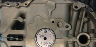

Although socially challenged, we were able to confirm Race 33, the ex-Greenamyer Lancair Legacy now being piloted by Elliott Seguin is this year’s first casualty. Technical major-domo Andy Chiavetta and Elliott were still consulting the data tea leaves this morning, but the broken connecting rod and decapitated piston visible through the pair of holes in the Continental 550’s case put to rest any thought of running the plane any more this year.
The pirep from Elliott was he sensed an engine issue during qualifying and was dialing back the power in a rapid, yet controlled manner when the engine let go. Central to the failure is it takes a trained octopus to fiddle with the manual throttle, mixture, propeller, ADI, ignition and other controls while flying a sick bird with a bank vault glide path to a safe landing. Unfortunately, it’s often not humanly possible to reduce the load on these highly-stressed engines before they succumb to any excess drama.
