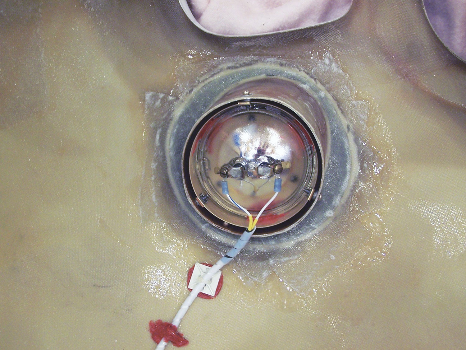

I now have a GlaStar under construction in which I installed a 100-watt GE 4509 incandescent landing light in the cowling using the factory installation kit. It has been in the cowling for the last few years while the rest of the kit is nearing completion. It has always bothered me that I can’t have the light output that I used to have in my old Bonanza. The 8-amp current draw of this 100-watt lamp is the only benefit. It also bothered me that I had no taxi light and no convenient place to put a taxi light. My GlaStar has the optional auxiliary fuel tanks installed in the wings near each wingtip. The tanks fill the space, leaving no extra room for a Van’s style forward-spar installation of landing and taxi lights in the leading edges.
