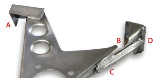

Let’s start this installment with an explanation of common upholstery terminology. Photo 1 shows an average aircraft seat without its cover. You can easily see the frame and foam. What you can’t see in this photo is the support beneath the foam. This seat has springs covered by canvas. Other seats, such as in some Mooneys, may have just a piece of sheet metal where this seat has springs. Many Experimental aircraft are similar to this in the sense that they have foam cushions sitting on sheet metal. On some aircraft seats the springs have been eliminated, and the canvas has just been stretched across the frame. When you design your seats it might be helpful to keep these three basic configurations in mind. Which one best suits your situation?
Photo 1: Without a cover. The letters designate features of the seat itself. Photo 2: Seat with seat cover. The letters identify parts of the seat cover.

Each component may have individual features. Here we see that the backrest has a lumbar support, labeled A. The backrest and cushion have bolsters, labeled B. This seat has bolsters on each side of the seat, and they are symmetrical about the centerline of the seat. The cushion has a thigh support, labeled C.
